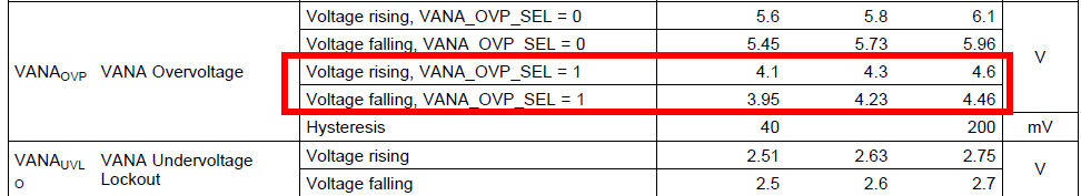

    To me it sounds like you are potentially seeing a VANAOVP event when changing to a higher voltage. For LP87702DRHBRQ1 orderable, the default VANA_OVP_SEL value = 1 is for 3.3V input with 4.3 V rising and changing to 5V would cause it to trigger, leading to regulator disable. If regulator is enabling/disabling, it can read as a lower voltage than expected (i.e. if it is 3.3 V output but the on/off cycle is 60% then it will measure 1.95 V with a DC multimeter). You could check if this is happening using an oscilloscope.

  • Hi Anish,
    See datasheet explanation about VANA_OVP. Based on that LP87702D disables all the output voltage rails and GPO outputs when VIN voltage is higher than VANA_OVP level. In this LP87702D case it is 4.3V. See Technical Reference Manual for LP87702D from here: http://www.ti.com/lit/ug/snvu593a/snvu593a.pdf
    Also you have noticed that connecting JTAG you see voltage on LP87702D outputs. And as you suspected I suspect too that MSP430 is leaking when there is no voltage present on its inputs.
    Also PGOOD_WINDOW for VANA is different function than VANA_OVP. PGOOD window for VANA only affects PGOOD PG0 and PG1 pin outputs. Also VANA_THRESHOLD affects only PGOOD detection. VANA_OVP is different function and as it is defined to be 3.3 VIN for LP87702D device there is no way to change it for this device spin afterward.
    So nominal VIN for LP87702D is designed to be 3.3V. Or higher than 2.63V and lower than 4.3 to avoid VANA UV/OV protection resetting device.
    For your final question it is not possible to run LP87702D device from higher VIN voltage than 4.3V.
    If you need LP87702x spin for 5V VIN voltage please contact TI sales representative.
  • Hi Anish,
    In your original post your said you have configured BUCK outputs up to 3.3V when BQ24075 is supplying LP87702D. There is the limitation on datasheet for VIN/VOUT difference also. See below. With 3.3V VIN maximum output is either 2.5V or 2.3V depending the required output current.
