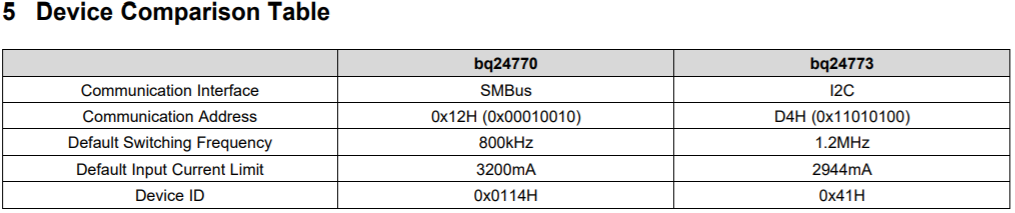

Previously, I worked with BQ24770 and now I need to work with BQ24773.
I identified only one difference between them. The BQ24773 needs 1.8V connected via a 10K resistor on the SDA and SCL pins, while the BQ24770 needs 3.3V.
Could I keep 3.3V on the BQ24773 too?
Another point, the PROCHOT Pin is also connected with the 10K resistor at 3.3V, could I connect the PROCHOT Pin at 1.8V?
 I would like to use only one voltage regulator , 1.8V or 3.3V.
Thank you
  • Hi Pedro,
    Yes, you can use the same 3.3 V pull-up rail for both the BQ24770 and the BQ24773.
    The differences between the two chargers are summarized in the table below:
    Angelo
