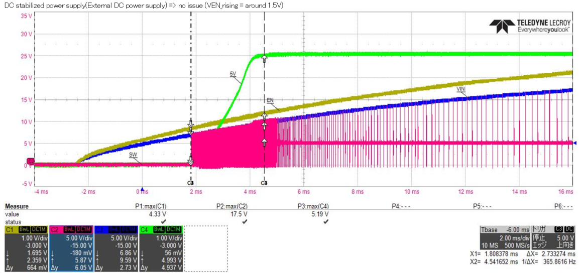

Customer have an issue  about not-match the LMR23630 enable threshold with their calculation result.
Could you please give me your advice for the reason of this issue?
Condition
Vin : 24V
RENT = 270kohm
RENB = 51kohm
VENH = 1.55V(typ), 1.7V(max)  : from datasheet
Vin_rising = 9.8V(typ)

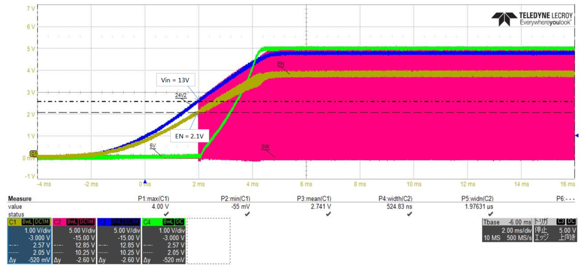

Measurement results
Vin_rising = 13V
EN_rising = 2.1V

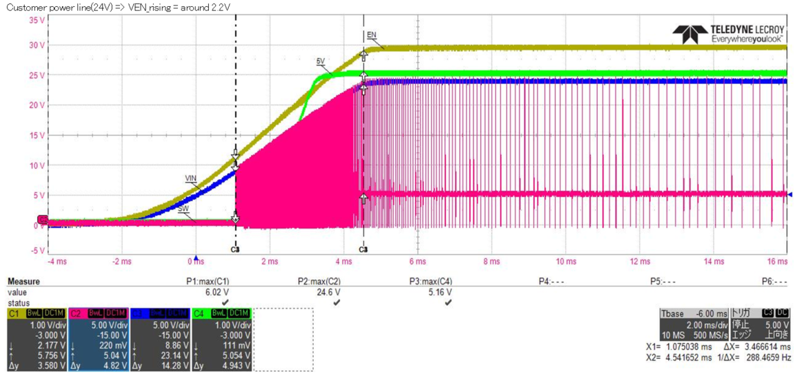

    Customer tried to check with EVM.
    In case of they used DC stabilized power supply, it is no issue. So, EN pin threshold is no problem.
    However, this issue occurred when they connect to their system power line.
    How do you think about the reason of this issue?

  • Hi Yusuke,
    I think it is related on the delay on when the threshold of EN is reached , there will be some delay before the part is start switching.
    If you slowly ramped EN or VIN in this case, you can see the effect of this delay is reduced and you can see the EN threshold voltage.
    Alternatively, if you increase EN or VIN as fast as you can, you can see how long is this delay before the part is switching.
    Thanks and i hope that answers the question
