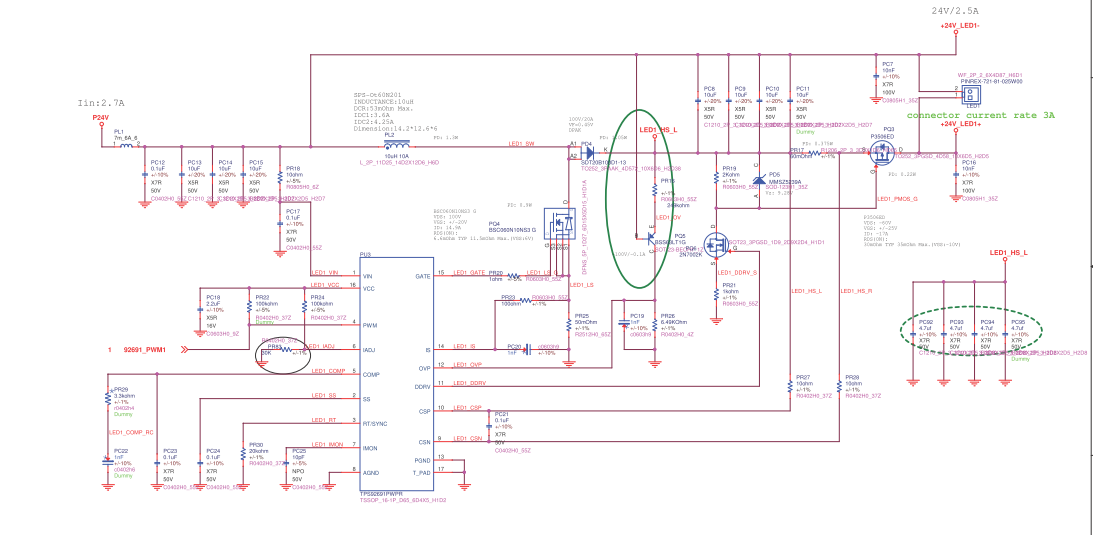

     Customer found our 6.3W LED device can’t be work normal. But 55W device seems ok.They make some modify on EVM board likes attached circuit BOM value.
But PR16 change to 150k and PR22 POP. Just using IADJ(Analog dimming).
Please check the circuit and waveform if any customer can try.
If this solution can’t be support CV mode they may consider to change solution. Has any comments for 6.3W LED fail issue? Thank you.

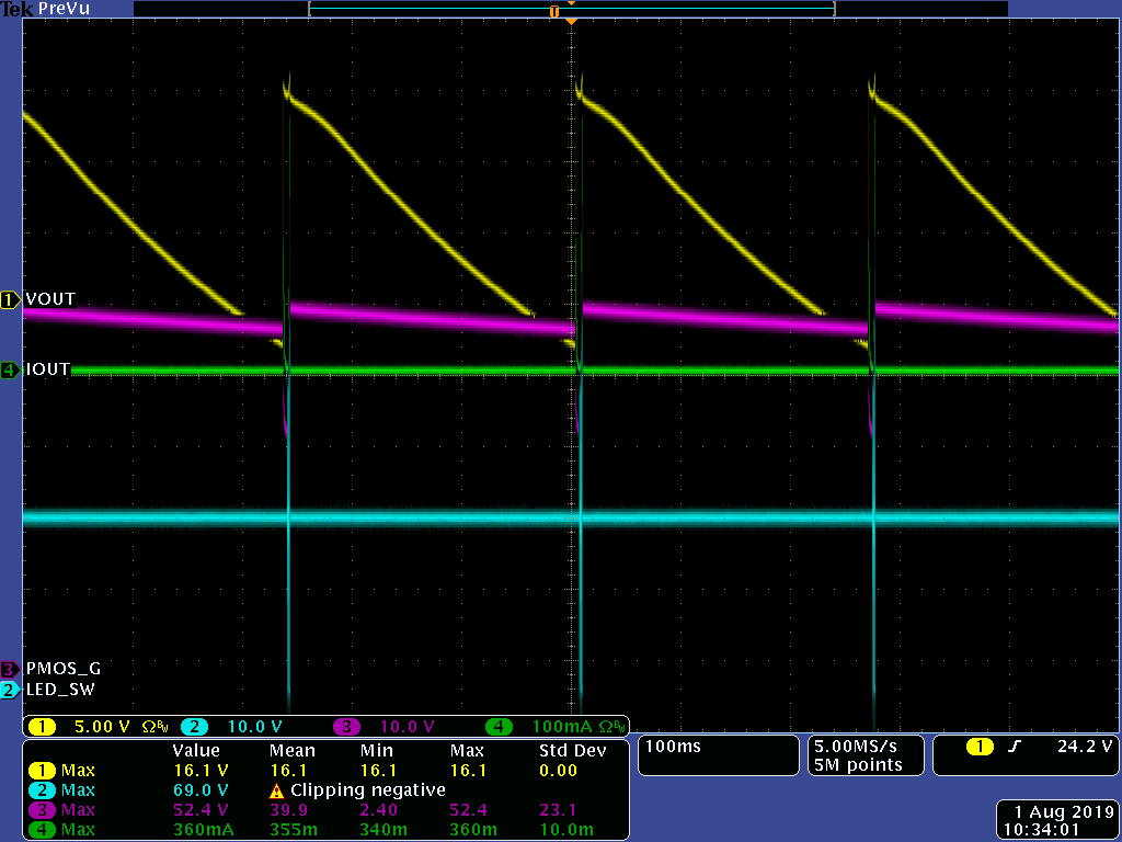

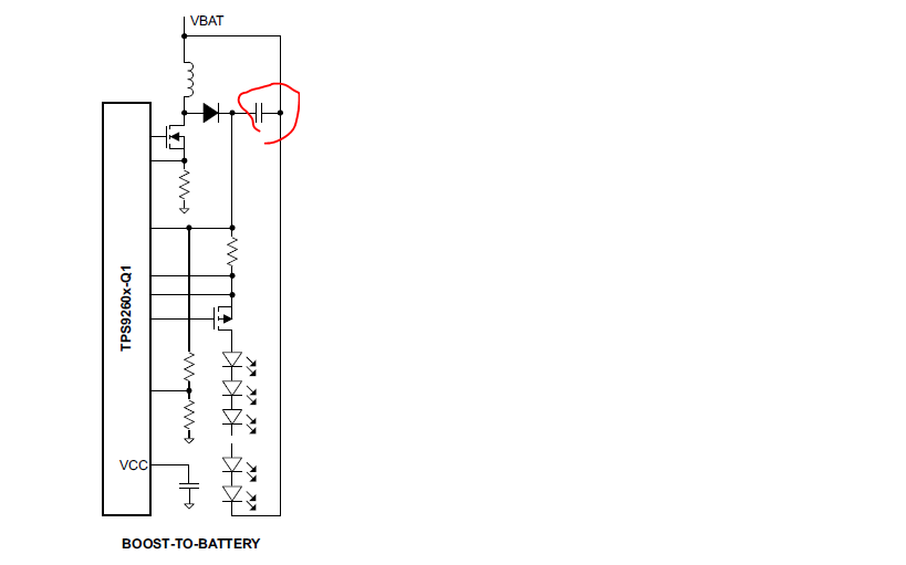

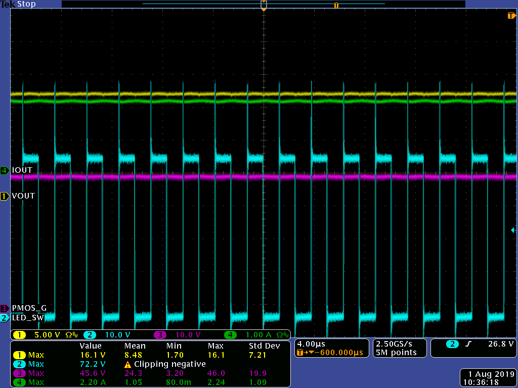

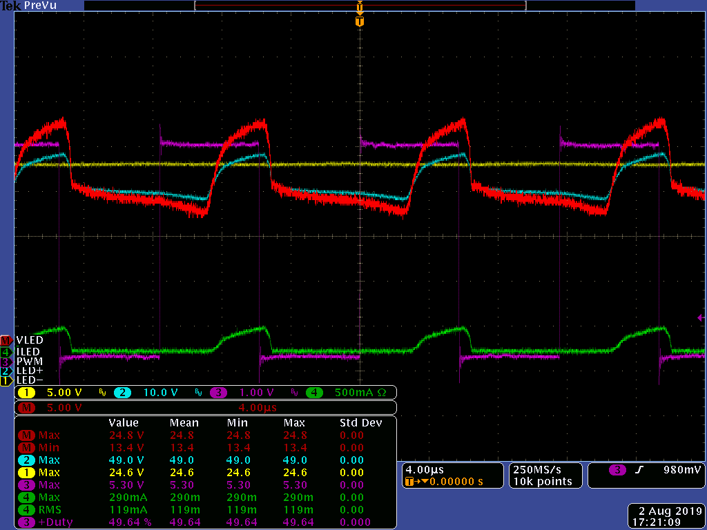

             Customer used TPS92602 EVM board to do Boost-to-Battery architecture to meet our requirement.
    But the VLED/ILED waveform seems strange at PWM 50% duty.
    Vin: DC24V, LED Vout: DC24V, LED current: 2.5A max. CV mode control.

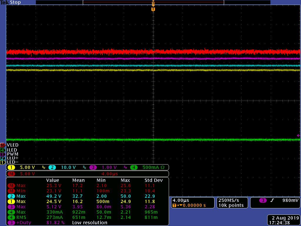

    1. LED 55W; CV mode 24V, 2.26A
    2. LED 6.3W; CV mode 24V, 0.26A
    50% PWM duty
    100% PWM duty
    BR
    Patrick

    For the TPS92691:  What is the input voltage range...I see nominal as 24V on the schematic?  What do you mean by CV?  This is a current controller.
    Can we have a scope capture of OVP pin voltage to verify that it's tripping the OVP ans zoom into the rising edge of the OVP.
    We cannot read any of the values with the schematic you capture here.  Can we get a better schematic file?
    In general, it can be design to work with both case.  It's very confusing here that you mentioned that OVP is the issue.  Are they using the same LED?  What is the forward LED voltage?  You mention 24V for both...This is the confusing part.  The output voltage should be the same for both.
