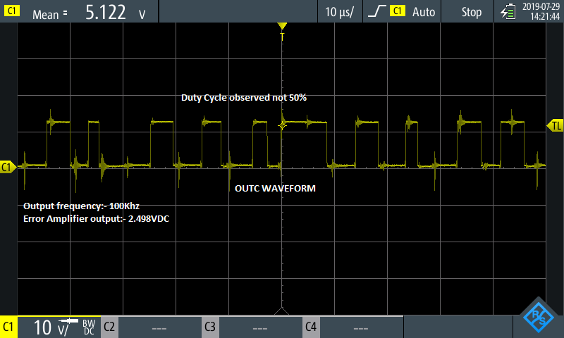

we are designing a 10KW phase shifted Full bridge DC DC controller using IC UCC3895. we did an open loop test by disabling feed back to the controller and we loaded up to 10KW smoothly. Issue reported while we closed the loop. Issues are listed below.
  • At no load output is regulating at 100V and no noise, burst mode is working.

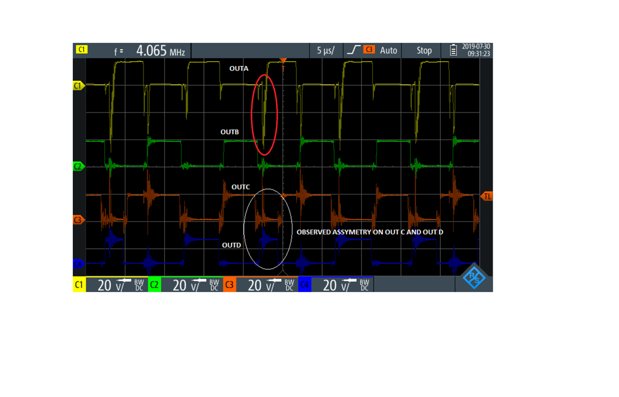

  • When we loaded around 300W( Output voltage 100V and input voltage 200V). Output is regulating at 100V noise is generating from the magnetic parts, while cross checking we observed asymmetrical pwm pulse output(between OUTC and OUTD). we work around as per the application note from TI SLUA275, but still issue not resolved. We increased Ramp voltage to 1.15Vdc by adding voltage divider from Vref output.

    We are observing same waveform on input of the driver and output of the driver.
    We are attaching a waveform of OUTC from the PWM controller.

     1,Do the OUTA and OUTB have same issue or not?
    2,could you please share you SCH in here?
    3,Can you please share OUTA OUTB OUTC OUTD in same waveform?

  • Dear Bliss
    A:- NO issue observed

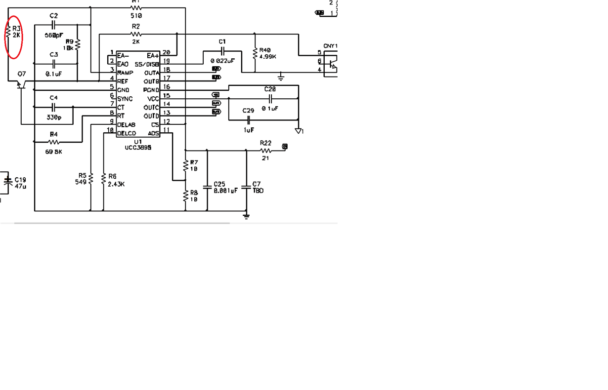

    A:- Attached schematic
    A:-Attached Waveform

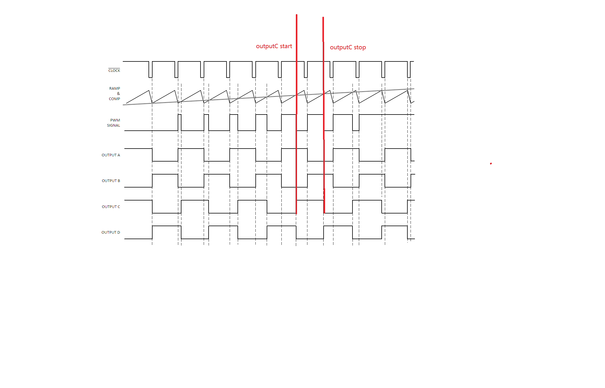

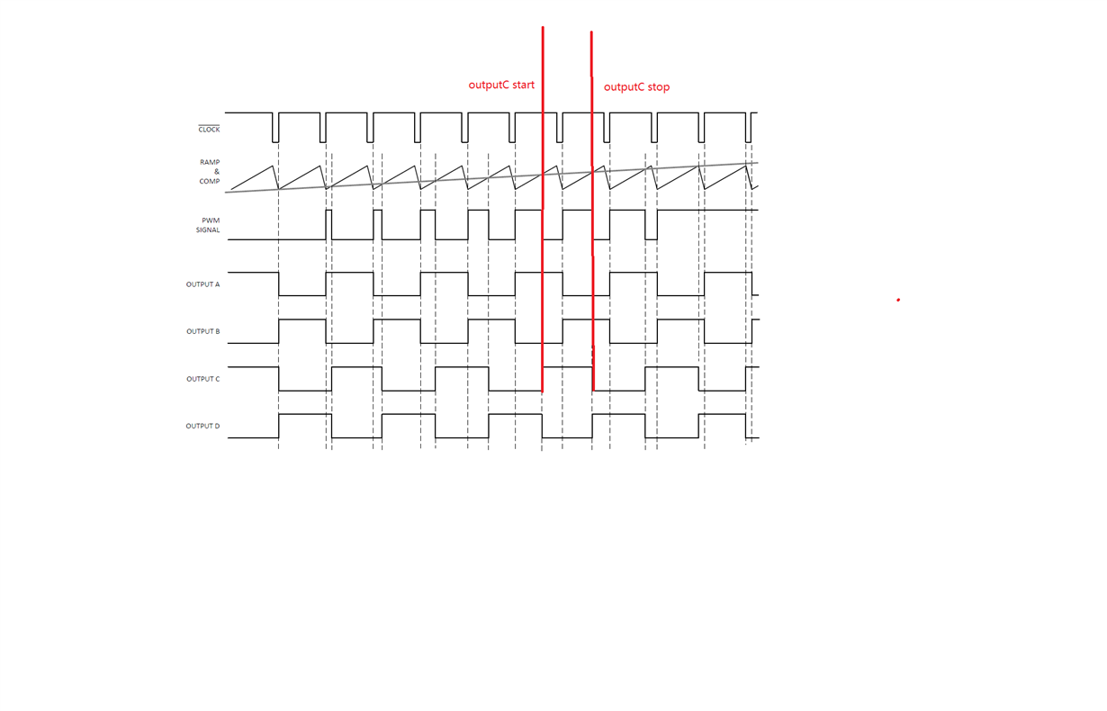

  • Hi Sarma,
    I am happy hear from you.
    as my attach waveform from datasheet. OUTPUT-C start and stop,it is closely related to RAMP and COMP.
    so, some suggestion for you.
    1, you need to check the comp signal is stable or unstable.
    2. your RAMP from CT,
    a, you need to check this signal is clear or not.   for your waveform OUTA, there is strong interference signal. it may cause distortion of CT current signal detection.You can try filter the current signal appropriately, but it may not be effective.
    b, I think you need to add Slope compensation on RAMP PIN. please refence http://www.ti.com/lit/ug/sluu109b/sluu109b.pdf
    c, for got stable CT current signal, I suggest you put you CT on the input Bus. please refence http://www.ti.com/lit/ug/sluu109b/sluu109b.pdf
    3,  what is the value of R55 R56 R57 R58? these Resistors should be 10K.

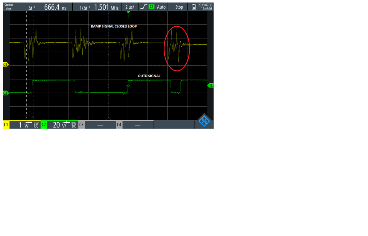

  • Dear Bliss
    We have checked Ramp and comp pin wave forms please find the waveform attached. Please check and provide your comments.

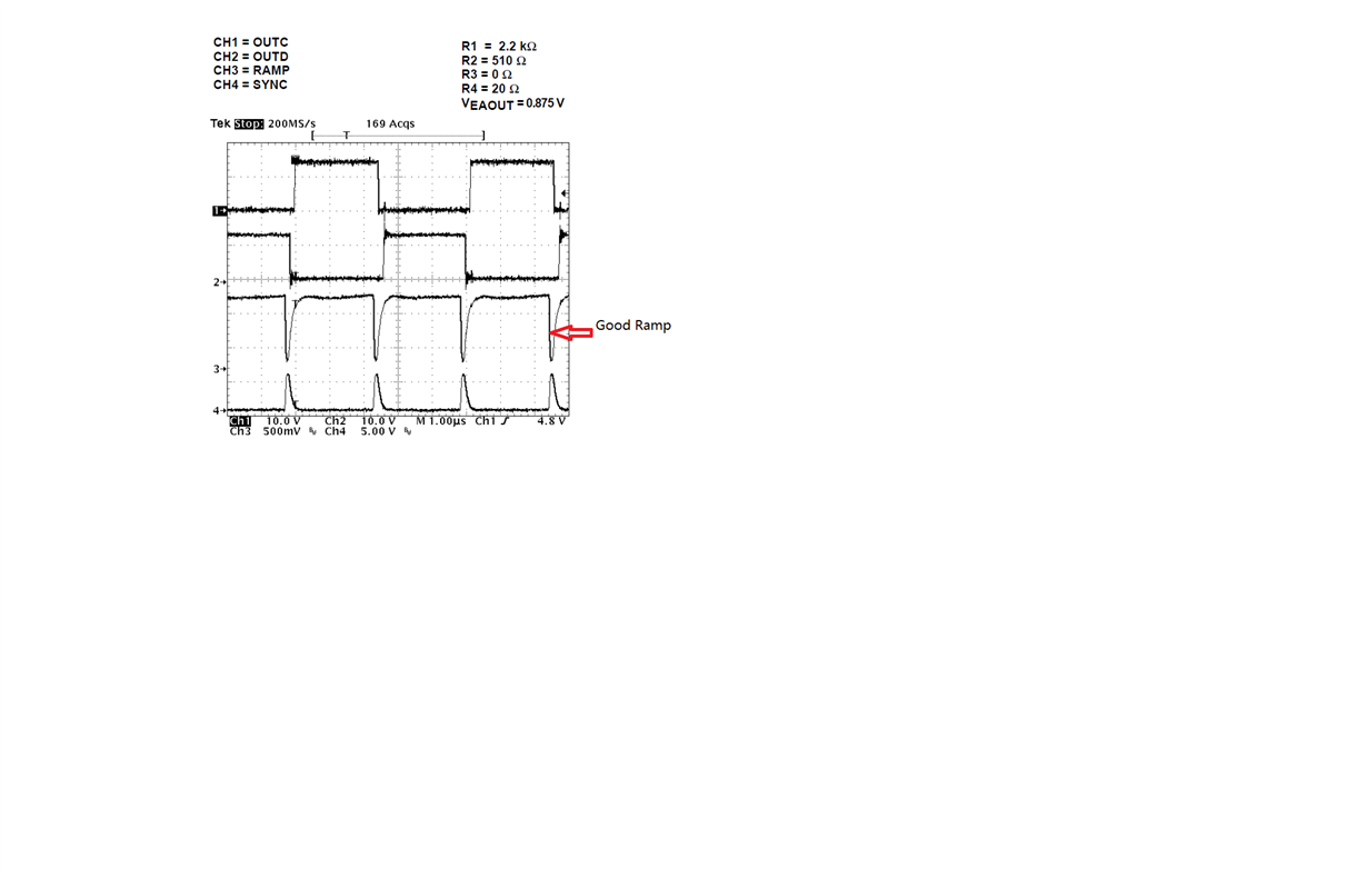

  • Hi Arun,
    1,I reviewed your waveform.  It seem that there is significant interference on the Ramp signal. I just put good Ramp Signal at here for reference.
    2, for  slope compensation, I put the Key circuit for you. there is no R3 in your SCH.

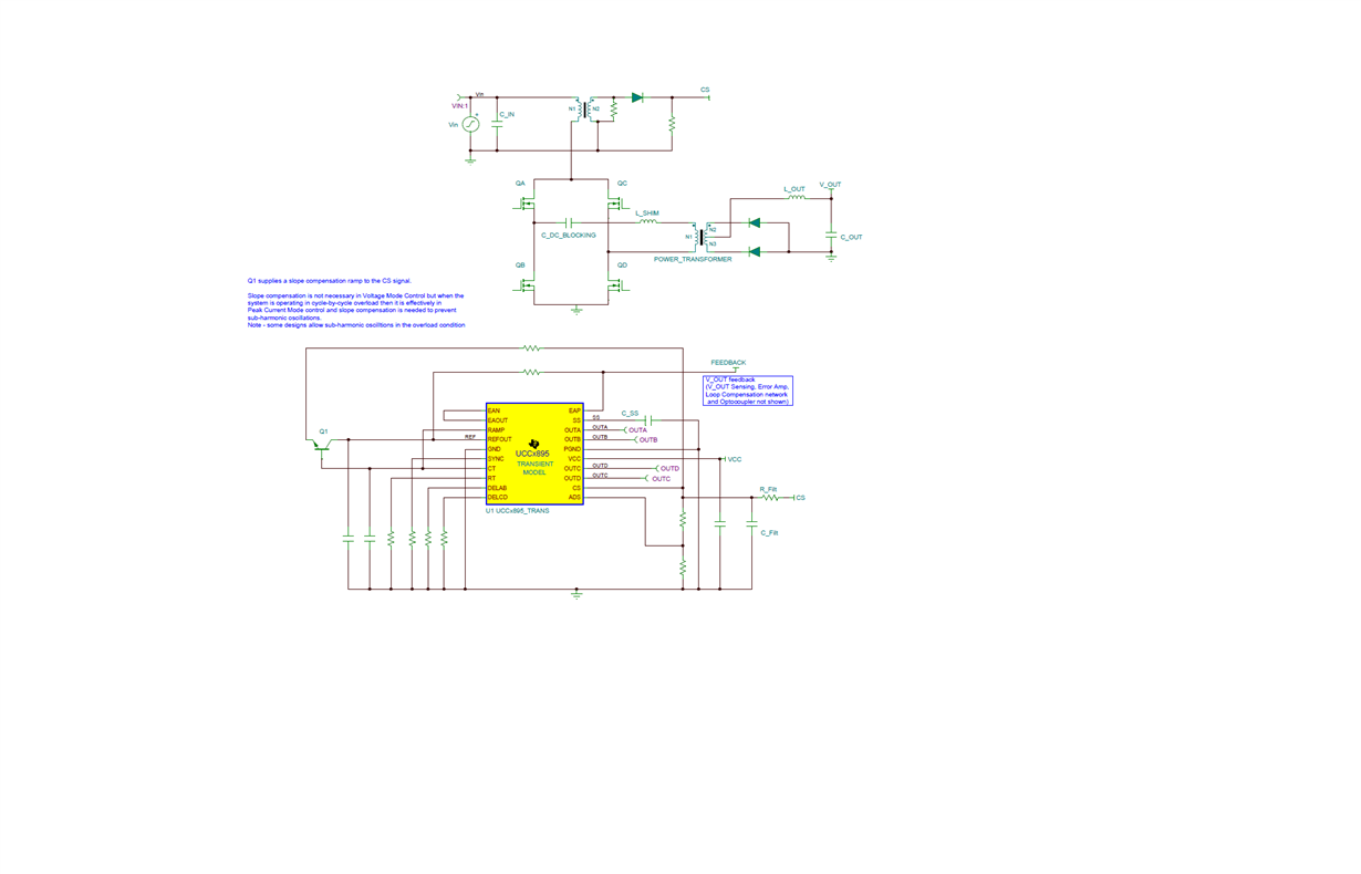

  • Hi Arun,
    UCC3895 in Voltage Mode control. The figure do not show the secondary side error amplifier (TL431), loop compensation or opto-isolator circuits. you need to design it by yourself.
    1,A DC blocking capacitor to the primary of the transformer – this is necessary in VMC.
    2,Q1  provide a slope compensation ramp – this is used ONLY when the system is in current limit and may be omitted if the designer can accept sub-harmonic oscillations in current overload conditions.
    3,Please calculate component values by yourself.
