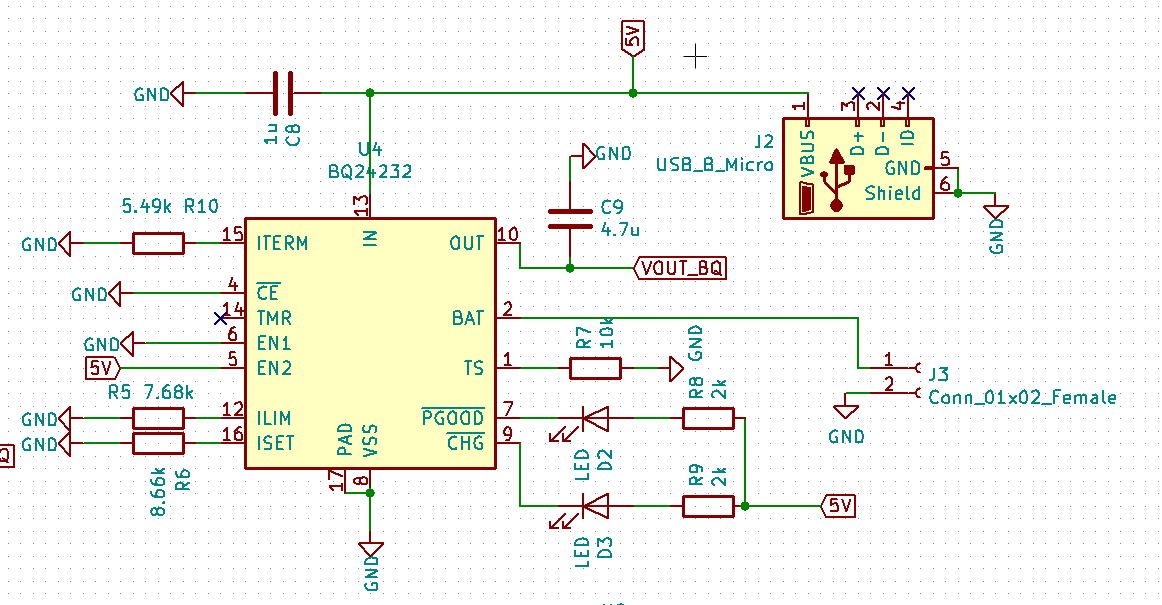

BQ24232: No output on V(OUT) with V(BAT) at 3.7V
Part Number: BQ24232
It seems I have a few issues using the BQ24232. One of them being that when the battery is connected to V(BAT), the IC does not output anything on the V(OUT) pin. That is true with V(IN) being fed with either 0V or 5V. Despite this, I was able to confirm that the /PGOOD pin goes into low impedance when V(IN) is connected.
Please see the current schematic that I am using:
Any idea what could cause this issue?
