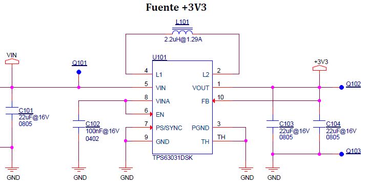

I have designed a board where I use the TPS63031. The input voltage is from a Li-ion battery (3.3 V to 4.2 V), nominal current is less than 5 mA and max current is 500 mA.
I use an inductor with a Isat = 1.29 A.
There is an audible noise, the noise is higher when maximum current is present.
I attached the schematic of the DC-DC converter.
In the board, I don't have the choice to change to power-save disabled, so, I don't know if it's something exclusive of power save-enabled or  it would have the same problem with power-save disabled.
Could you help me to understand the possible causes of the problem.

    This is the schematic.

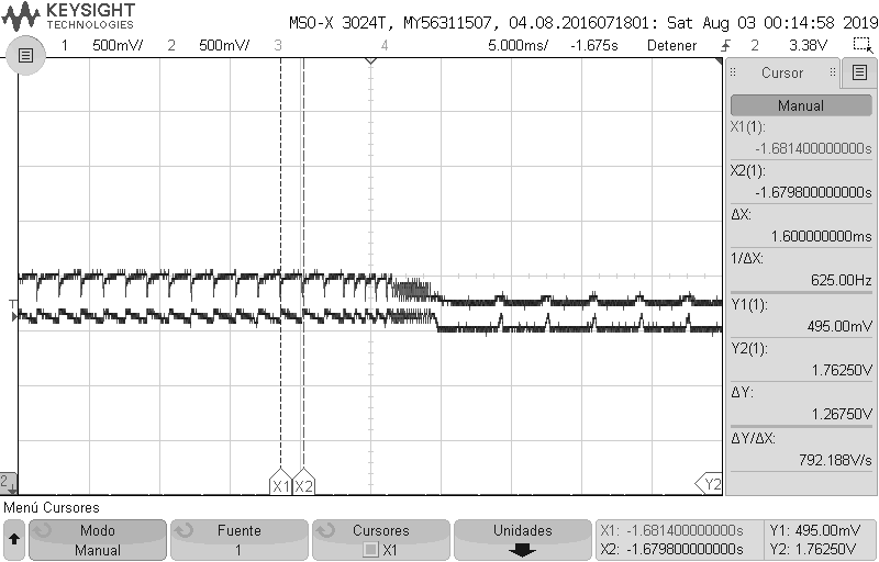

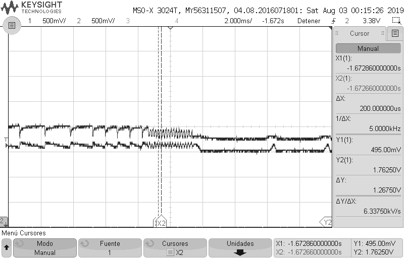

  • I attached the waveforms of VIN and VOUT, L1 and L2, I can't measure it.
    The bottom signal in the images is VOUT and the other is VIN.
    In first image the frequency is 625 Hz. This is when typical current is consume, less or equal to 5 mA.
    Second image is before maximum current is consume and the frequency is 5 kHz.
    Same thing is when voltage goes from maximum current to typical current. In transition about 5 kHz and then with typical current is about 600 Hz.
  • Hi Asael:
    The TPS63031 has higher than 2MHz switch frequency. So the frequency you see in the waveform about full load is not exactly switch frequency.
    May I recommend you to debug the system step by step? It will be easier to locate the issue.

  • Frequency in the waveform indicated with the cursors are in Hz or kHz. When the cursors indicate about 600 Hz the load is a light load and when the cursors indicate 5 kHz is before the full load. With full load I have a greater frequency.
