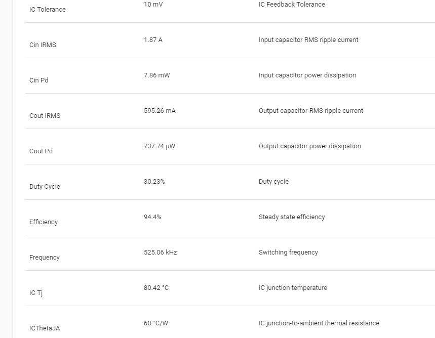

I was looking at web bench for ic to convert 12V to 5V with 4Amp which I found TPS565208.
My question is power dissipation and how hot the ic will get
Base my understanding you calculate junction  temp:  (Vout-Vin)Iout x (1-%Efficiency)  x Ramp= (12-5)*4*  (1-.94)*95C/W = 159.6C
But if you look at the web bench you will see the IC junction temperature 80.4C so which one is correct
even if look at TPS565208 EVM does this board can handle 3Amp without heating up
 Link to webbench

  • Sure I also look at web bench for another part TPS40305DRCR too, my main questions  how do I calculate how hot these devices will be when you have :
    Vin = 12 9Amp

  • Hi Amir,
    Please refer to the webench model indication for the right thermal data. If you would like to calculate the IC junction temp, you will need to use the equation: Ta(25C)+IC Pd*ICThetaJA=IC Tj. For ICThetaJA, it is not reasonable to use 95.9C/W from datasheet for calculation. ICThetaJA is a value that is heavily depending on the PCB board. For the real world PCB, you will always see a much lower ICThetaJA value compared to the datasheet value. So it is good to use 60C/W like the webench showed.
    IC Pd could also refer to the webench data. Or you could just use the power loss as a rough estimation Vout*Iout*(1-eff%)/eff%
