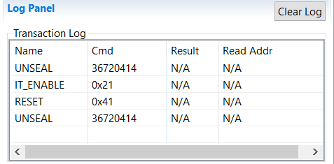

    I have completed what is probably my 12th learning cycle attempt, following the TI instructions set forth in SLUA902, none of which have ever updated Qmax or Update Status after the charging section. These learning cycles have proven to be a complete waste of time over the past many weeks. I would like further clarification on why these learning cycles are not seeming to take. Attached is my log file from the attempt.
    1. I have programmed the ChemID (3547), design capacity (1300mAh), terminal voltage (3300mV), discharge and charge current thresholds (both 35mA), quit current threshold (25mA), and taper current (50mA).
    2. With the battery fully discharged, but PCM closed (battery voltage around 3200mV) and fuel gauge powered, I enable an impedance track and a reset command. As the cell is already discharged and below the terminal voltage I don't need to discharge it more. Rather, I wait 5 hours as instructed.
    3. Charging commences and lasts for a few hours until charge current is around 30mA, at which point the charger is turned off. The FC bit gets set. I let the battery relax with the charger off overnight, yet the Qmax and Update Status are never updated. I can confirm, as shown in the log file, that the fuel gauge is always powered. Everything is done at room temperature.
    A couple questions / comments:
    1. I've noticed the Transaction Log in the bottom right corner of BQStudio never shows me a result when I send commands. Every result is N/A. Is this normal?
    2. The fuel gauge always becomes sealed during the learning cycle, although I never seal it myself. Is this expected?
    3. Is there any way to just send the battery to TI to get this learning cycle done and receive a golden image file?
    Thank you and I appreciate some assistance. Log file below:
    Tue27Aug_RadioBatt_LearningCycle.log
  • Hello Robert,
    -Your terminal voltage should be set to the minimum that your cell is rated for and not 3300. After learning is successful, you can set that to the 3300 which your system requires. However, I would not recommend using 3300 as your terminate voltage as using a high value can cause issues.
    -you should not be using  a device that is sealed. A reset command will seal the gauge again.
    -You must have sealed the gauge unknowingly at some point. Once the device is sealed, it can never return to a permanently unseal state. To get the gauge to be able to return to a permanently unseal state, program the default firmware. link below
    -Unfortunately, we do not perform learning cycles for customers. Can you let me know why the cell voltage is reducing instead of relaxing upwards. This could be preventing the gauge from taking a proper dv/dt measurement used for calculating the qmax. You need to determine if your cells is being loaded by some components on the board.
    thanks
    Onyx
