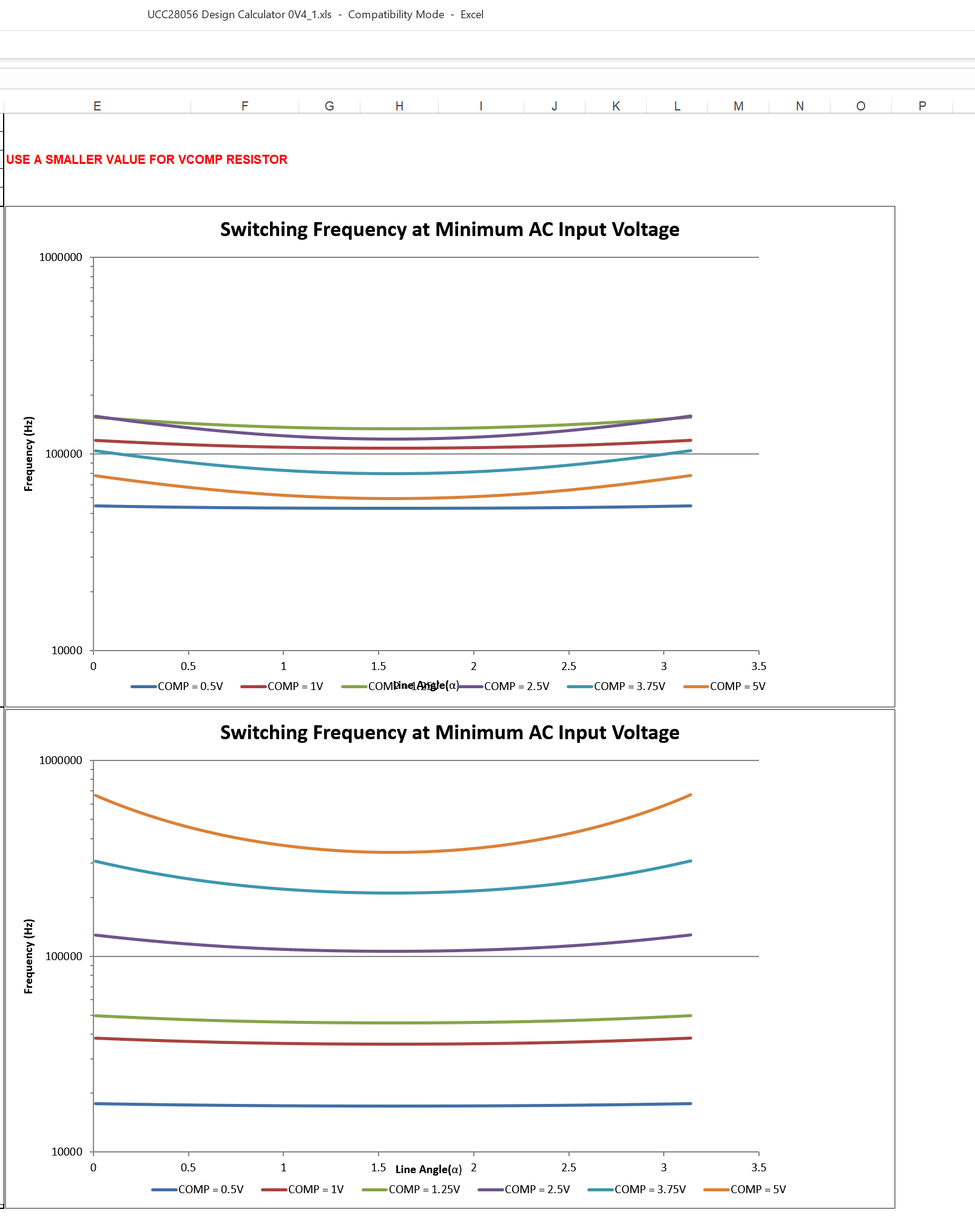

  • Another question. It appears that the calculator gives different plots for the same operating criteria (Switching Frequency at Minimum AC Input Voltage).
    The top plot has the switching frequency gathered around 100kHz, the bottom one has a much wider dispersion but they are labeled the same.
    The bottom plot is showing the switching frequency profile over maximum AC line. It is a typo in the UCC28056 calculator. It is possible to adjust the switching frequency profile depending on the inductance chosen. This would move the operating point at which the controller drops into DCM operation and the operating point at which the controller operates in burst mode as well. What is the switching frequency range your design needs to operate?

    To provide further context, the recommended inductance uses the full voltage range of COMP (0V to 5V with 5V representing maximum load). By reducing the inductance value, this changes the COMP voltage that would correspond to max load. For example, if the inductance is is reduced by 25%, the COMP voltage will only reach 3.75V at maximum load. This means the on time when in transition mode will be smaller than if the recommended inductance was used.. This also means the load point at which the controller drops into DCM operation will be larger and also the load point at which the converter transitions into burst mode will be larger.
    In the UCC28056 design calculator, the switching frequency is plotted for various values of COMP voltage. This information can be utilized to determine an appropriate inductance if a minimum switching frequency requirement for your application.
