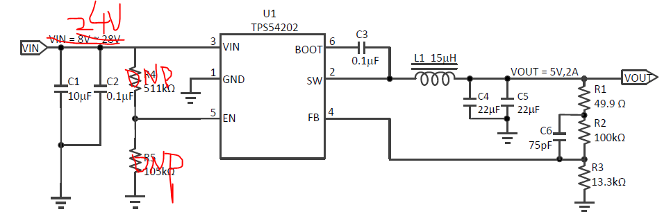

TPS54202: chip damaged when connect 24V power in
Part Number: TPS54202
Hi TIs
when I plug in the 24V as VIN of TPS54202, the chip is damaged immediately. Seems the thermal between VIN and SW pin burn it out within 100ms. And then, the VIN to GND is short.
the schematic is as below, I just let the EN pin floating, is that related to this issue?
