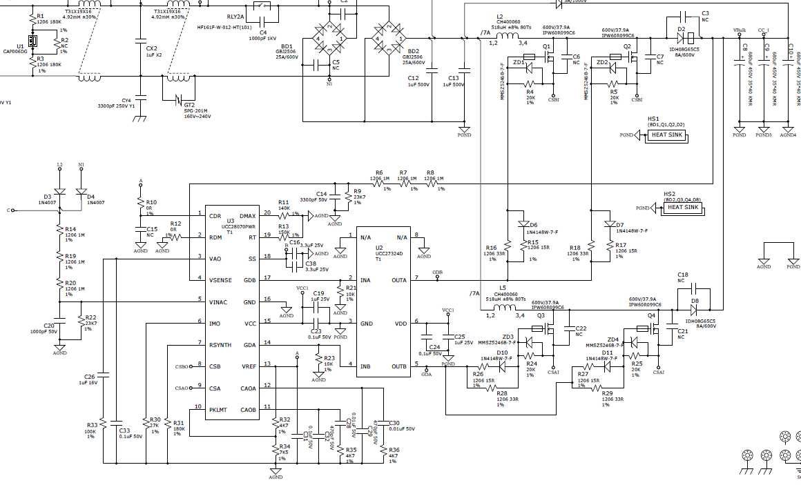

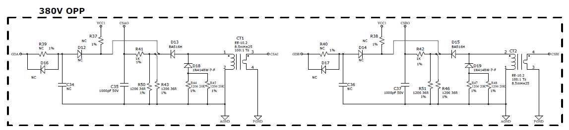

Hi team,
My customer has used our UCC28070 to implement their pfc circuit.
They have faced some abnormal waveform of UCC28070.
The application specification :
Vac=120v, fs=50kHz, Pout=1200W
Ch1, Ch2: 2-phase current waveform, Ch3: phase1 gate voltage
Would like to consult with you the reason to induce this abnormal waveform happened?
My customer also mentioned that there is chance to burn out the power mosfet.
Is it possible to related with the abnormal waveform? Thanks.
