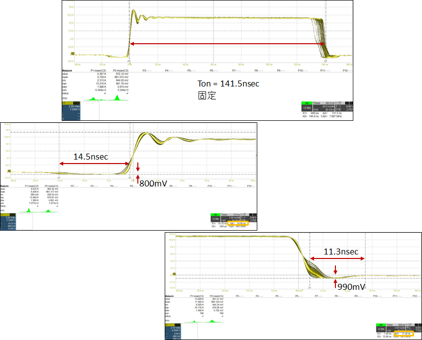

Hi, Team,
Could you please check the attach waveform? Is there no problem?
It should be fine, but I need comments from BU...

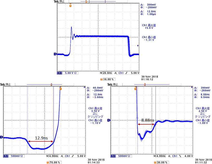

Yone-san,
During the dead time the low side body diode is conducting and you may see additional voltage drop exceeding -0.3 V. Additionally there will be sone additional voltage undershoot on the fallen edge. The specification is -5.0 V for 10 nsec. Your time are only slightly longer and the voltage drops far less than -5.0 V. Also, the jitter does not appear to be excessive. I do not see any issue with those waveforms.
