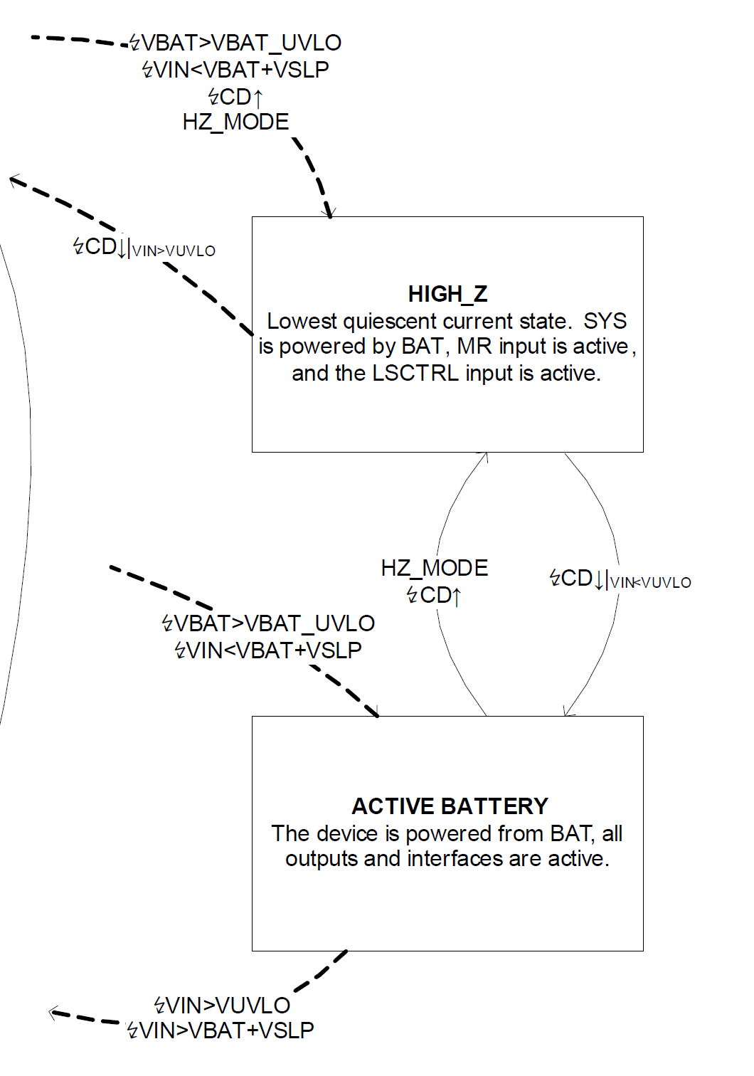

    I am looking at the state diagram from the datasheet, and it seems to be contrary (also to observed behavior). How to interpret this diagram correctly?
    Another follow-up question: The difference between highz and active battery is that the i2c interface is off in high z. Other outputs such as sys, ldo outputs are not affected in high-z mode?
    The state diagram is correct. You'll see the arrow goes into Hi-Z mode when /CD is high and the arrow points to leaving Hi-Z mode when /CD is low and VIn is present.
    For  the second question, you're correct.
  • Allow me to follow up on the state diagram. I am unclear about why the transition from high-z to active battery happening when /CD is low and Vin being absent. Does it not contradict Table 1 (CD state table) ?
    If you take a look at the diagram, you'll not that it says "CD" and not "/CD".
