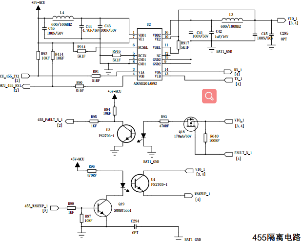

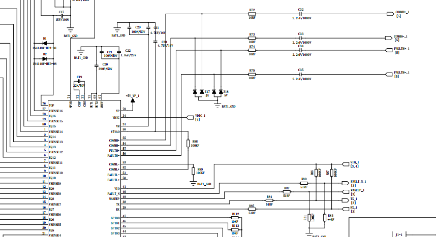

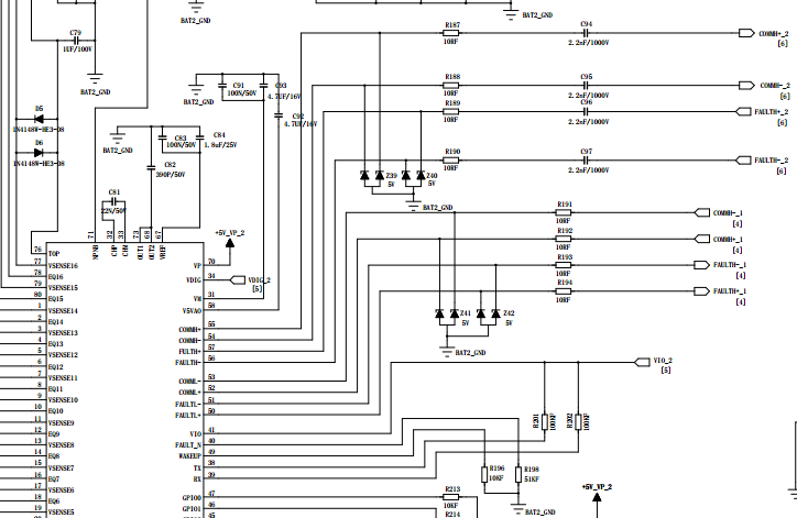

  • Thank you for reply! Schematic diagram is as follows. 6PCS bq76pl455a-Q1 series to connect 96 cells in same PCB,daisy chain connect witih  Cap isolate.
    Based on your description of a UART communication error, the issue is likely from the isolation device used between the microcontroller and the PL455.
    Please probe both sides of the isolation device and see if there are any issues with slew-rate, pulse-width consistency, and frequency. Compare the input and output carefully to make sure no issues are being introduced on the lines.
    If you are seeing issues between the device communication lines, we recommend using the datasheet values for the COMM lines components.
    For the TVS diode, we recommend an extremely low capacitance diode, in order to not affect the rise-time of the communications. Our datsheet recommendation is the NXP PES5V0U1UA. Please probe the rise-time of the communication lines and make sure they are within datasheet spec. If you have an EVM available, comparing the rise-time to that will help visualizing the differences!
    Let me know if this solves your issue!
