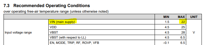

Hi
Because the MOSFET are in the converter, the spec only show the SW(low side MOSFET) max voltage=32V.
We want to know the high side MOSFET max voltage=?
Thank you!

Vivian,
The absolute maximum voltage is 30 V. The recommended maximum voltage is 22 V.
