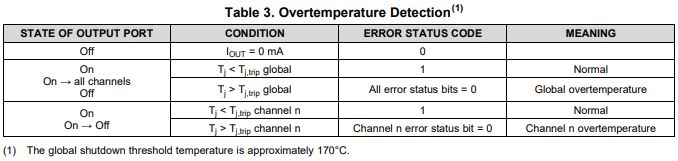

Hi team
I checked the status of detection and operation when over temperature in datasheet as the below.
Are Tj.trip and Tsd the same?
The maximum value of Tj is displayed at 150°C.
Is there a problem if Tj.trip exceeds this temperature?
