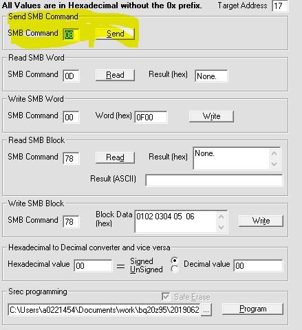

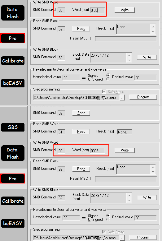

Hello
1. I enter the ROM mode and import the SENC file and then restart the bq Evaluation Software. I can't connect to the bq Evaluation Software.
2, I entered the ROM mode to export the SENC file, and then sent the 0x08 command, the board is also not connected to the bq Evaluation Software.
Thank you!
Please note that to enter program mode or ROM mode you need to use command 0x0f00 sent to 0x00. To exit it you need to send command 0x08. That will exit you from ROM mode.
