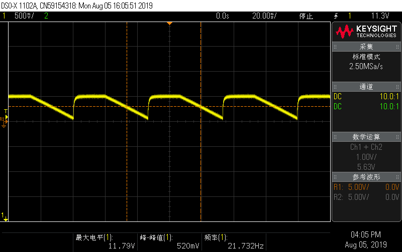

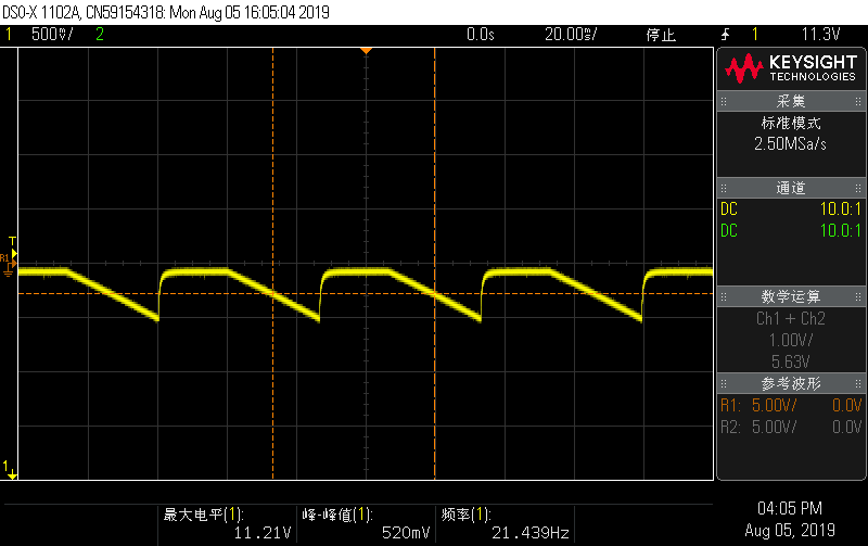

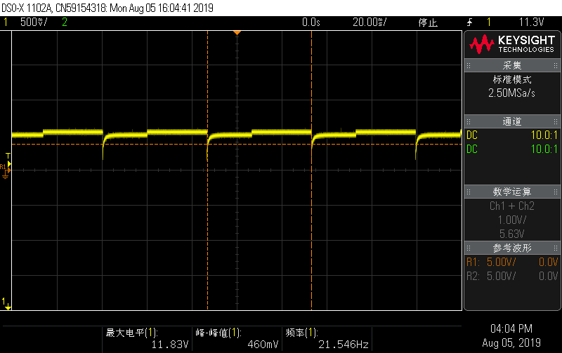

Hi
BQ24170 is used as charge management IC, and 12V digital power supply is used as input. The power source ground and chip's ground are connected by a 0R resistance. After power on, noise of about 20hz is generated on the input side of 12V, which affects VBAT and SYSTEMOUT ( VOUT output).
Attached schematic
Input waveform
VBAT detect waveform
System output waveform
Please give some suggestions

    Your e2e post says BQ24170 but the schematic says BQ24172.  If BQ24172, CELLS pin becomes FB and it cannot be shorted to ground as shown in the schematic.  Also, the BTST cap, C7) is too large.  We have only tested with 0.047uF.  D1 isn't needed for reverse blocking if you have Q1 and Q2.
    If battery is not connected but input power is connect, the BATFET should not be on to connect BAT to SYS.  Is BATDRV to Q3 high or low?  Is there a short from BAT to SYS?  Also, if truly BQ24170 with CELLS low, VBATREG =4.2V, battery detect signal should only go to 4.2V not almost to the input voltage.
