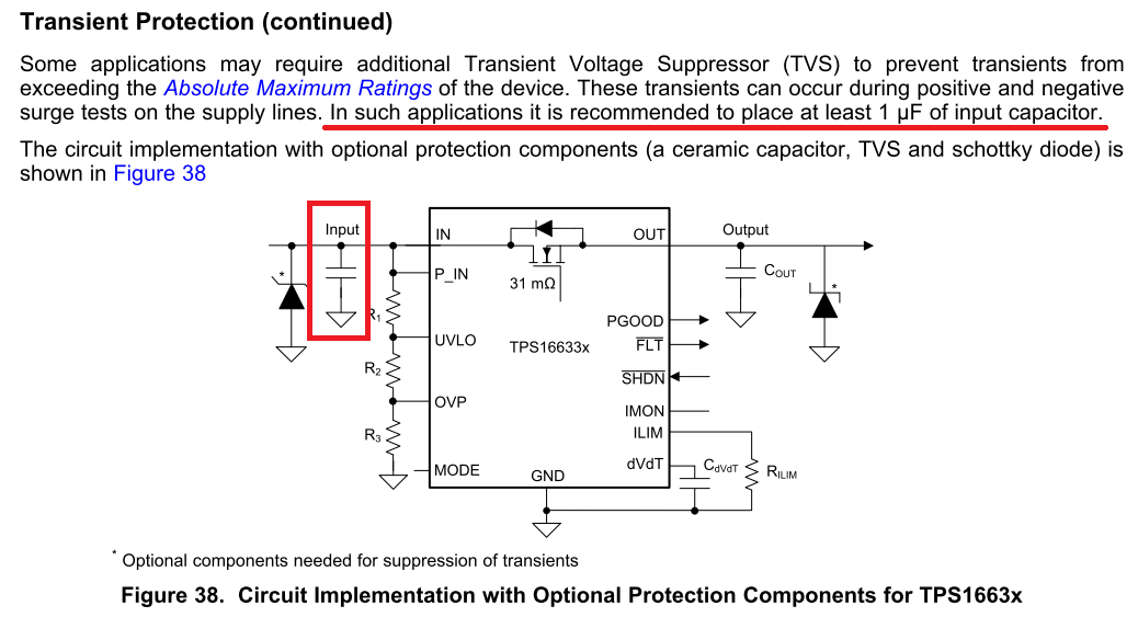

The input capacitor is mentioned in the TPS1663 data sheet as follows. So, could you please tell me that reason why 1uF is required in detail ?

Hello Kato-San,
A 1uF cap on input is recommended to absorb the energy during the transients and limit the voltage at input of TPS1663. The exact value of cap required will be a function of source impedance, load current and transient voltage.
