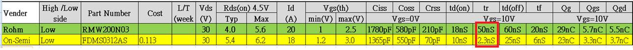

Hi Expert,
I want to use the below MOSFET in TPS51220A LS, could you guide me which one is better? Any concern? Thanks!
VIN=24V
Vout=12V
Iout=5A
For low side MOSFET, the first one should be better. Power loss on low side MOSFET is mainly conduction loss. So a MOSFET with lower Rdson is better.
While for the high side, switching loss dominated, so small Qg is preferred. Thanks!
