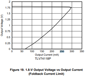

1.) I would like to know can TI provide Output current limit graph like below for TPS7A25?
Below graph are taken from TLV741P datasheet
2.) The Output current limit written in datasheet is Min:325mA Typ:510mA Max:720mA
May I know any possible scenario will trigger the current limit exceed 500mA?
ZY
  • Hi ZY,
    The TLV741P has a foldback current limit whereas the TPS7A25 has what we call a brick-wall current limit. What this means when a short occurs, it will be limited to a limit in the range you list above. When a device is in current limit, it means that the load is drawing more current that we are allowing the device to supply so the net result is VOUT will typically fall. As VOUT falls, the power dissipation across the device increases and typically leads to a thermal shutdown.
    Now to answer your question on the possible scenarios to enter current limit, this could be either there is too much current drawn by the load or a short at the output of the LDO.
    I hope this answers your question.
