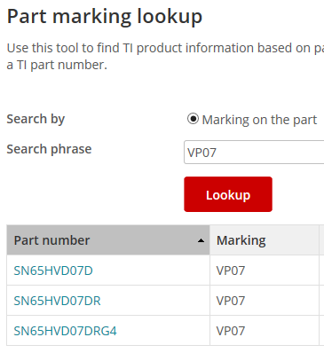

Hi Jeff,
There is a convenient Part Marking lookup tool on ti.com: http://www.ti.com/packaging/docs/partlookup.tsp
Input VP07, you'll see this is the SN65HVD07.
