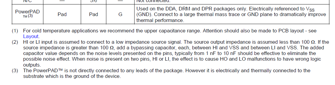

  • Is the "Exposed Thermal Die Pad" under the DDAR package chip grounded?
  • Hello Meng,
    Below is a clip from the datasheet pin description table.
    As the datasheet states, the power pad is not wire bond connected to the ground pin of the driver, but the power pad is connected to the substrate of the IC. There can be some resistance in this connection since it is a die attach compound. For parameter measurements, and PWB trace connections the pin 7 VSS should be the ground connection reference. To improve thermal performance the power pad should be connected to a ground referenced PWB trace or plane. But this connection should not be considered the current carrying path.
    Confirm if this answers your questions or you can post additional questions on the thread.
