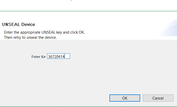

Another things is how to unseal the gauge, I clicked the sealed command on the BQstudio by mistake, and I tried to unseal it by click unseal and input the unseal key36720414 according to the TRM, but it doesn't work. And I didn't do any change code things.

    If you didn't change the code, the default keys will be the same. Close bqstudio and then restart it. Then click the unseal command button in the command window. The default keys is already contained in the button. After the device is unsealed, then click the full access button as well to put the device in full access mode.

    I did the process to unseal the chip but it dose not work. Is it default code to unseal is 36720414 as defined in the TRM. If it really doesn't work, any other solution to solve the problem?

    Can you sent a snippet of your register screen. The default codes works if your didn't change the passcode.
