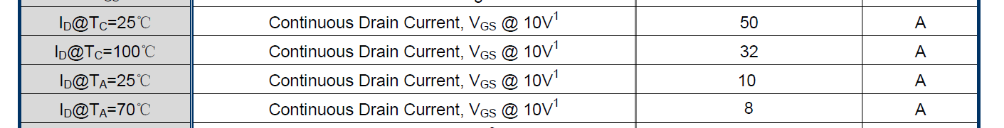

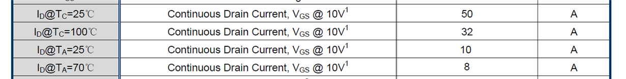

    The first figure is  from wsf40n06 datasheet, the second one is from  CSD18543Q3A.
    When we compare these two devices, which parameters should we focus?
    And the customer required the heating current is abbout 20A, but I'm not sure about which parameter indicate this requirment? Both for TI and WINSOK device.

    Let's start with current ratings. The numbers in the datasheet are usually calculated based on thermal impedance and on resistance. Is the heating current of 20A continuous or is it pulsed? If it is pulsed, what is the pulse width and duty cycle? If it is pulsed, then we need to use the transient thermal impedance curves in the datasheet to determine if the FET can handle the current. A 5x6mm QFN (or as TI calls it SON) package can dissipated a maximum of about 3W with a good layout and depends on ambient temperature and airflow (if there is any). The QFN includes a large thermal drain pad on the backside of the package which can be used to dissipate heat into the PCB. The FemtoFET is a family of LGA parts in very small packages and is much smaller than a SOT23. It can dissipate about 0.5W maximum with a good layout. For more information, please check here: .

    The CSD18514Q5A may work for the heating application. Of course, it is a 40V BVDSS and that usually means a larger die size than a 30V FET for the same rds(on). The maximum power dissipation with VGS = 10V and Tcase = 25C: PD = I2 x rds(on) = (20A)(20A) x 4.9mOhm = 1.96W. The on resistance increases with temperature (see Figure 8 in the datasheet) so at Tcase = 100C, the dissipated is multiplied by 1.5 or 2.94W. This is pushing the limits of what the 5x6 QFN package can dissipate. Please review and let me know if you have any additional questions. There is a 6 part blog series for understand MOSFET datasheets here: e2e.ti.com/.../MOSFET+Blog+Series
