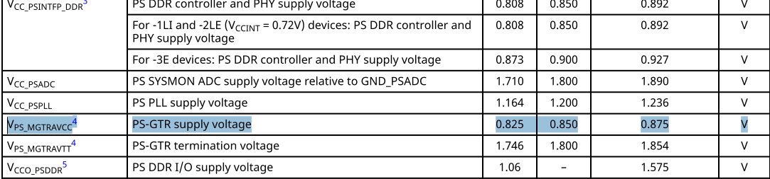

1. For PS domain, Xilinx FPGA datasheet said Vps_MGTRAVCC needs to be 0.85V as below picture. But in our datasheet Figure-6-9, the VTT LDO output for Vps_MGTRAVCC is 0.9V. So is it wrong in our datasheet?

    1. For the VPS_MGTRAVCC, the specification was changed from 0.9 V to 0.85 V after the Ultra96 board was developed. My understanding is that while 0.9V is not officially supported, the 0.9V would only make it perform slightly better at the cost of additional power usage. The official recommendation for new designs is to use an external LDO instead of VTT LDO or to use one of the LDOA2 or LDOA3 instead but that requires using a customized version of the TPS650861 based on TPS6508641.
