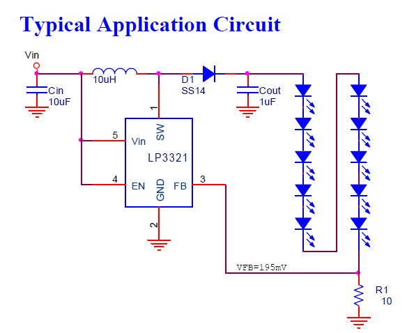

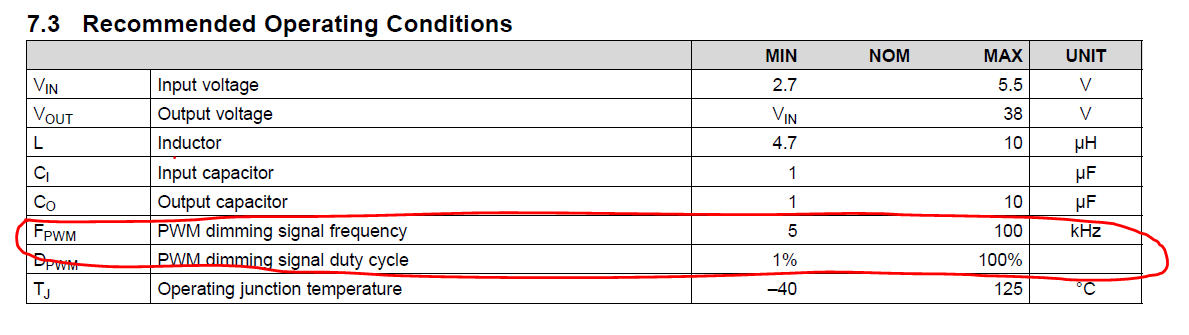

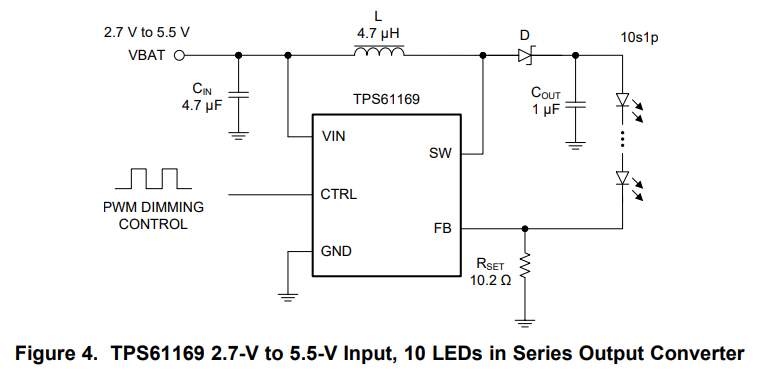

I used a LED driver LP3321 (Low Power Semi) before, now I want to replace it with TPS61169, but I want to know how to deal with the Pin4 (Ctrl) .Whether the Ctrl Pin can float?
below is TPS61169 and LP3321 schematic.

I have an other question: Which part(TI part) i can use to replace LP3321 directly?
Lemon Shen
Hi Lemon,
TPS61169 is the most similiar one, but the package is a little smaller than the LP3321. You can help to check whether customer can use our TPS61169 which can also save the space.
