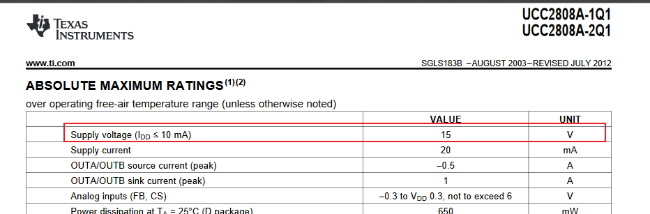

UCC2808A-2Q1: VCC ABSOLUTE MAXIMUM RATINGS
Part Number: UCC2808A-2Q1
Supply Voltage is15.5V, is that ok?
Thanks!
  • Hi Neal,
    15.5V exceeds the absolute maximum voltage rating of VDD unfortunately. Are you able to step down the voltage feeding the VDD pin?
    Ben Lough
  • Hi Neal,
    Stresses beyond those listed under Absolute Maximum Ratings may cause permanent damage to the device. These are stress ratings only, which do not imply functional operation of the device at these or any other conditions beyond those indicated under Recommended Operating Conditions. Exposure to absolute-maximum-rated conditions for extended periods may affect device reliability.
    So please use recommended  VDD range 13V~14V. Thanks.
