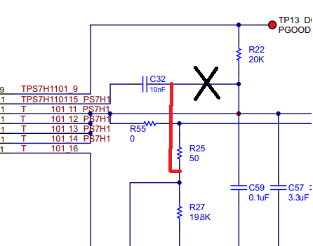

TPS7H1101A-SP: bode plot measurement
Part Number: TPS7H1101A-SP
Team,
In section 8.1.1 of the datasheet there is a mention of the inner loop. I want to know more detail(s) on how TI was able to measure the inner loop? What we are looking is for the crossing frequency and compare the outer and inner crossing frequency. If you can provide what tools you use and measuring points to connect the Bode plot that be great.
