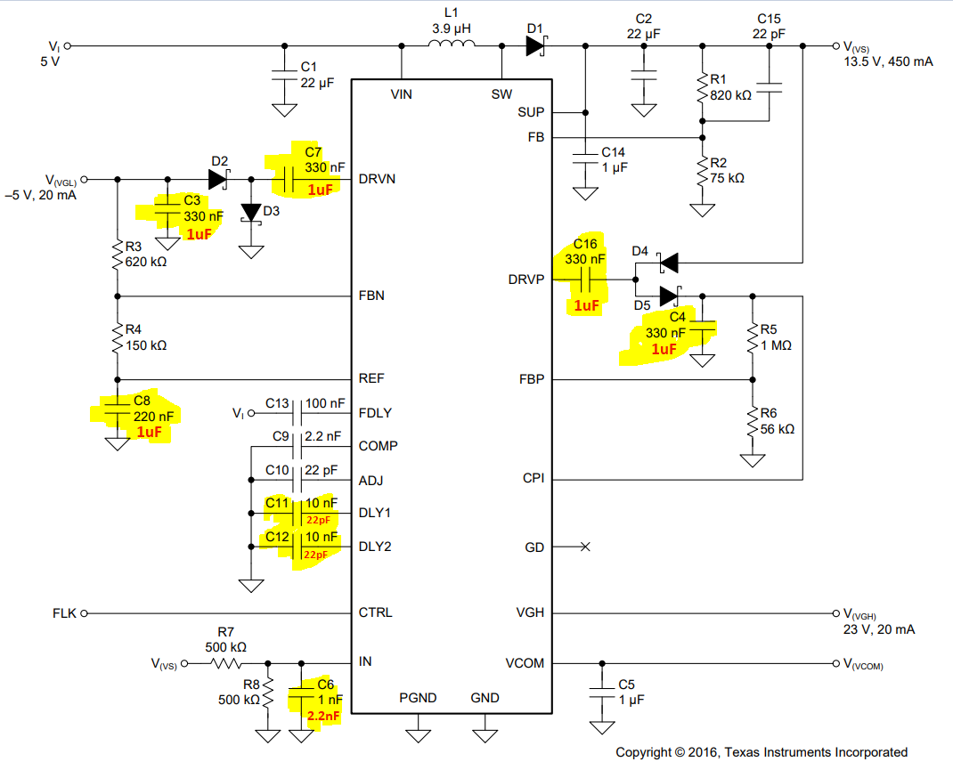

TPS65150: Capacitor Value Consolidation
Part Number: TPS65150
Could you look over these modifications I made to the typical application diagram? A customer would like to reuse the low cost capacitors already in their library, as opposed to having several different capacitors of slightly different values as suggested in the diagram.

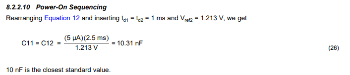

The only obvious change we see is that adjusting C11 and C12 will increase the start up time from about 1ms to 2ms. Is there any issue with this?
Thank you!
Thank you!
