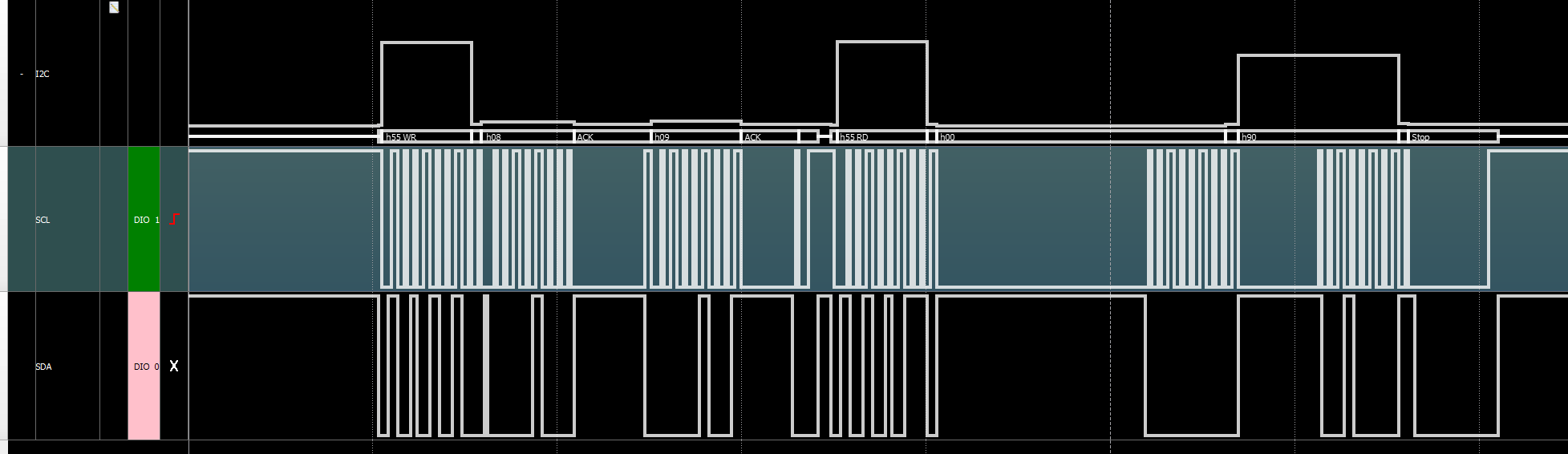

I want to use the bq27750 chip to read the state of charge of a 9V battery. For this I use the I2C interface of an Arduino.
I am not sure how to configure it correctly to get my information.
I start by sending the address 0x55 to start the communication.
However, I'm not quite getting through the communication protocol yet.
Which bytes do I have to send, if I want to know the current voltage value, for example.
I would build the protocol as follows:
0x55 (adress) - 0x08 - 0x09 and 16 bits for the answer. Is this correct?
Which general configurations do I have to make in order to be able to read out values such as charge state, temperature etc.?

Is an I2C protocol normally not structured in such a way that the address is sent, then the register to be addressed and then the data are transferred?
If I send it as described above, I get the following protocol:
I have measured the voltage at my battery and come to a value of 7.95V, thus 7950mV.
Accordingly, the chip should give me the following answer: 1111100001110 or 0x1F + 0x0E, possibly with a few deviations from the value... but not 144mV or 0x90.

  • hi Hendrik
    ps refer to the app note below on configuring the device. You absolutely have to configure the device using bqstudio. There is no way around this , Though app note is written for a different sister device, it is applicable to this.
    www.ti.com/.../slua777
    For communicating with the gauge using your arduino after you have configured your gauge following the app note above, see app note below:
