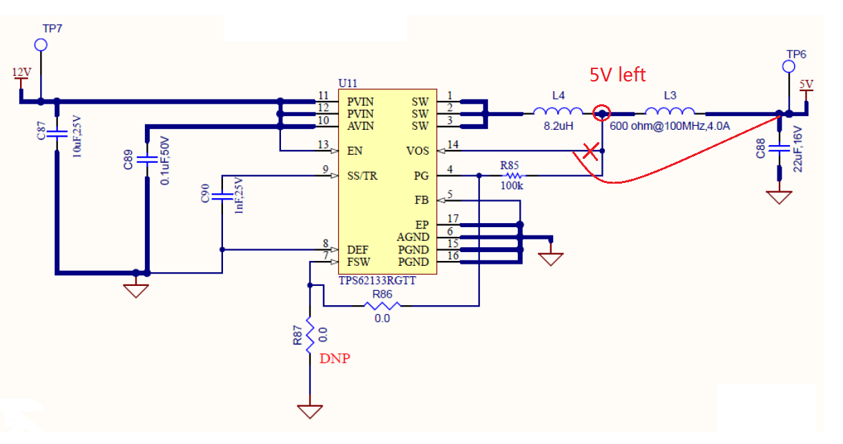

I am using the TPS62133 for a 5V / 2.5A supply.5V_PSU.pdf
With no load, I measure 5V, howerver with approximately 250 mA, the voltage rail drops down to 4.6 V.
It keeps dropping down with higher current demand.
Is there any error in the attached design?
Parts P/N:
C87: CL31A106KAHNNNE         Description: CAP CER 10UF 25V X5R 1206
C89: CC0603KRX7R9BB104     Description: CAP CER 0.1UF 50V X7R 0603
C90: C0603C102K3RACTU       Description: CAP CER 1000PF 25V X7R 0603
L4: PA4341.822ANLT                 Description:  INDUCTOR 8.2 UH   Current rating 4.5A    Saturation Current 6A
The layout is attached 4237.5V_PSU Layout.pdf. Note that C101 that appears in the layout is Aluminium 68uF/16V (P/N: EEE-FP1C680AP)
Thank  you for your help!
