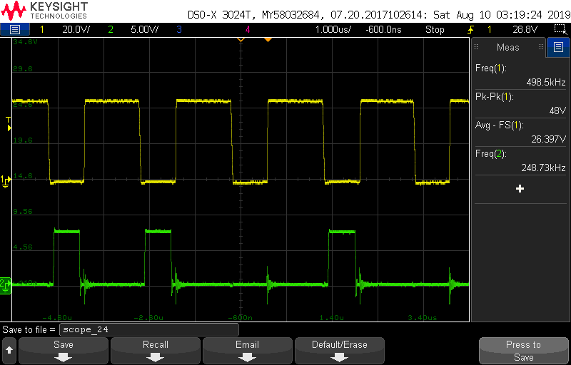

We are using an LM5116 in a 48v to 28v (2A max) SMPS design.  Under certain load conditions (~150-300mA) the circuit seems to become unstable and can often cause the low-side FET to fail.  We suspected our layout might be the culprit, but we were able to reproduce the issue using the LM5116EVAL board.   Any idea what may be causing this to occur?
Thanks....Alan
Small video link
Yellow:  Inductor input voltage
Green: Lower FET gate drive

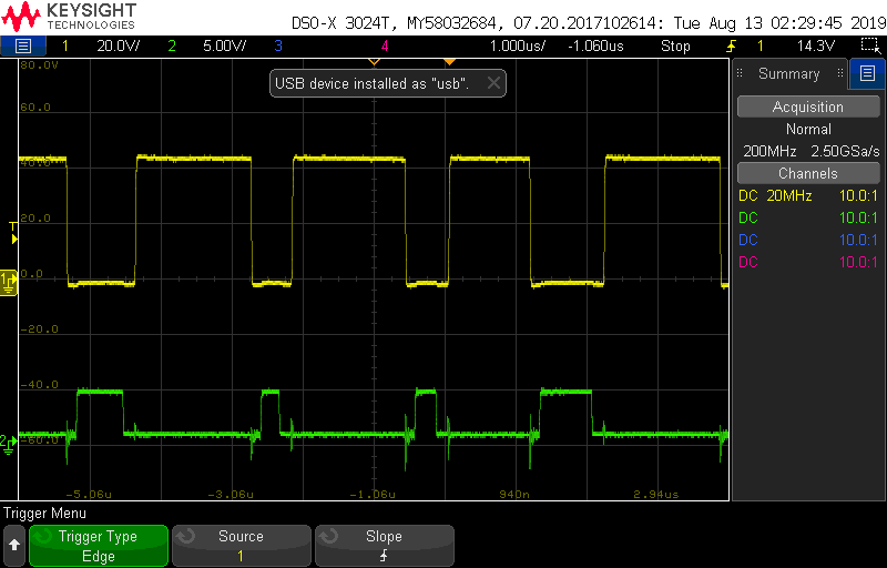

  • Hi Tim -Thanks for responding to my question!
    Update:  I was able to resolve the missing gate pulse issue by reducing the sw inductor to 15uH -but am not sure why this helped.  The ckt behavior is MUCH improved, but still a little quirky (see below).

    Yellow:  Inductor/switch voltage
    Vin=44VDC, Load: 2.0A
  • Hi Alan,
    The looks like loop instability. I notice that the compensation values in the schematic are different than the quicktart. Maybe you can reduce R74 and increase C113 values.

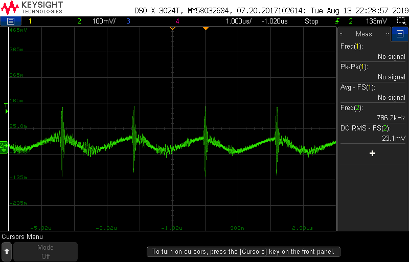

  • Hi Timothy,
    Changed  C113/C114, R74  to 2.6nF, 33p, 24K  quickstart values.  Also changed C45, 1uF/100V ceramic to a 10uF/50V cap (filtering seems ok, see below).  I also isolated/fly-wired the output inductor&cap onto the input cap to provide better/shorter ground paths.  Unfortunately, no stability improvement was obtained via any of these changes.  Any other suggestions?

  • HI Alan,
    Please send the layout for review. Also, can you send a waveform of the load transient response - that is a good indictor of stability.
    PS: that output ripple waveform looks stable.
    Tim

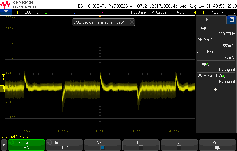

  • Hi Timothy,
    The transient response seems pretty good (see attached).  I sent you a link to the design files in a PM.  The output ripple appears stable cuz it was a one-shot capture.
    Thanks for your assistance -much appreciated!.......Alan

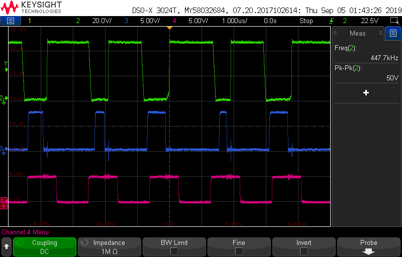

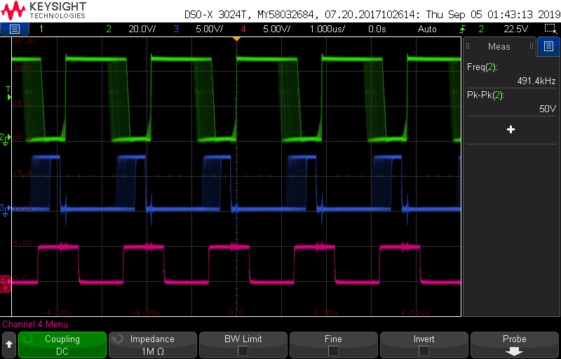

  • Hi Tim,
    Have replaced the switching FETs with 250v (vs 80v) devices.  Much less FET failures now.
    The circuit is still pretty erratic.  Seems to work ok otherwise, but would like to figure out what is causing the flaky behavior.  Its probably layout related, but....
    Tried different sync signal tests -with no improvement.  Tried on-board internal 5116 clock (no sync), PCB generated sync, sync via lab generator, various frequencies, duty cycles, magnitudes.
    Learned a couple minor things:  1) Circuit stops regulating (but looks stable) if sync duty cycle < 49%.  2) Certain sync freqs appear to stabilize the circuit, but it is load dependent.
    Have run out of things to try, so will close this issue for now.  Will reopen if new questions arise.
    Thanks......Alan
    Green:  FET/Inductor waveform, Blue: Lower FET gate Drive, Pink: Sync
    Single shot of the above:
