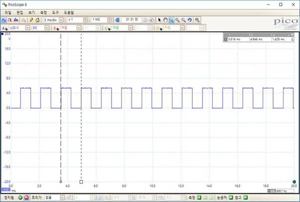

My customer is using TPS1H100-Q1 and need PWM control by IN(pin3).

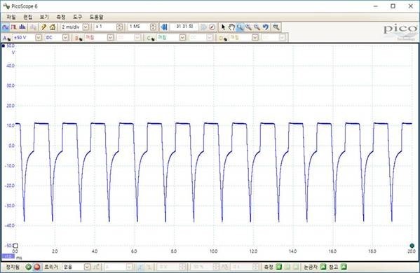

when PWM of duty 50% input at IN (pin3). it happened undershoot about -40V for OUTPUT at OUT (pin 5,6,7) as below picture.
could you advise me this problem. how to reduce undershoot.
PWM wave at IN (pin3)
OUT wave at OUT pin(5,6,7)
    This would happen if you have an inductive load on the output. This is not unexpected behavior as the clamp in the FET will turn it on at about -40V. I would say that I believe something is wrong with J20 because it should be clamping the negative pulse.
    I had removed J20 and tested it. but it is same operation.

    This behavior is not bad. It is expected when you are driving an inductive load. D20 should clamp this to the VF voltage which for normal diodes will be 1-2V.
    With or without the D20 the device is working properly because it has to discharge the inductive energy.
