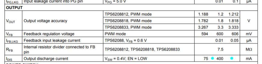

TPS62088: max output discharge spec
Part Number: TPS62088
My customer is wondering what is the max spec to output discharge function?
Because the discharge is too fast currently, so customer need to know about the maximum spec.
Please help to let us know about the maximum discharge capability.
Great thanks for your help.
    I can't extend the spec of the D/S if it is not reported.This parameter is strictly dependent from Vin and Vsw and in the D/S are reported only the typical and minimum output discharge current under specified test conditions. I can only give an order of magnitude that is around some hundreds of mA.
    Usually customers want to discharge quickly, so can you explain me which is your application?
    This application is SSD, the timing requirement customer have now is a window, not shorter better, so we need to know one reference value for timing calculation.
    Please let us know if you have more specific number of discharge capability.
