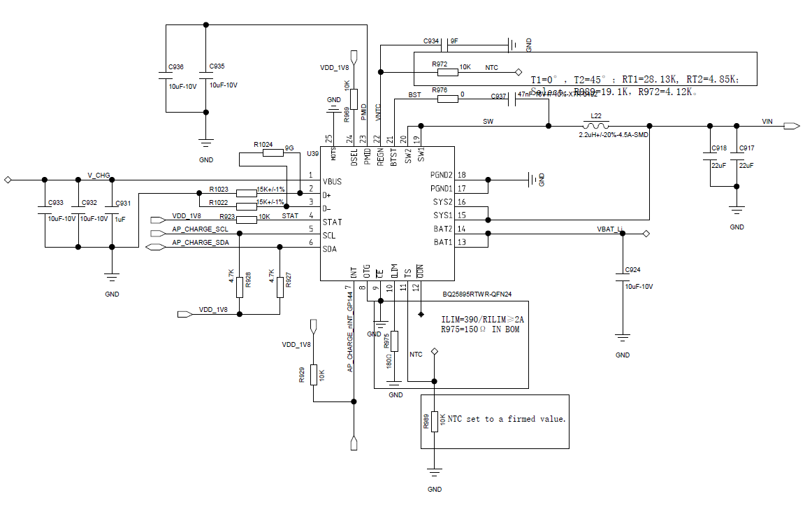

BQ25895: what's the refresh threshold for BTST?
Part Number: BQ25895
in the datasheet Vbtst-Vsw will be compared with Vbtst_refresh.
But I can't find the value of Vbtst_refresh.
My customer observe VBUS=4.3V when adaptor is removed, and the battery is 4.1V.
If we short VBUS to GND with a 1k resistor and then release VBUS floating, VBUS will be 0V and can't go back to 4.3V.
I guess it's uncontrolled boost back from battery to VBUS.
