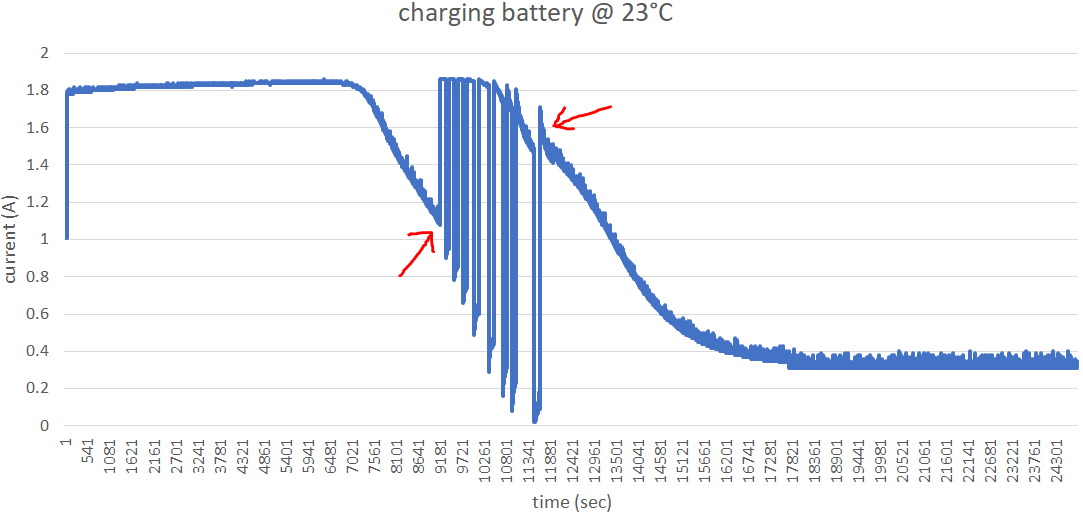

We are using BQ25601 in our system. However, we found after it enter into constant voltage status and charging current drop to nearly 1A,.Then, for some reason, the charging current will jump to a high value (2A ) for a while then drop back.to lower value, like 1A. The charging current will oscillating until battery is full. Can I ask why and is it expected behavior? Thanks!

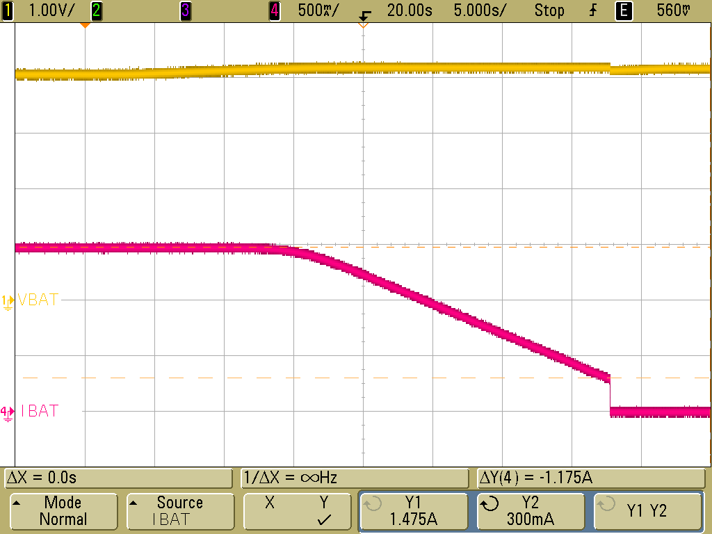

    This behavior is not expected. The charge current should taper down smoothly in CV mode. For example, in the waveform below, I set ICHG = 1.5 A and ITERM = 0.3 A. The charge current tapered down smoothly until the device entered termination.
    Can you please describe your test setup and test conditions in more detail so I can try to reproduce this issue? For example:
    1) Are you using an EVM or your own circuit?
    2) What is your adapter's voltage and current capability?
    3) What kind of battery are you using?
    4) Is there any system load connected?
    5) Is anything unusual being reported in the status and fault registers? Please provide a BQStudio screenshot to show your register settings.

    After making the changes above, do you still see ICHG oscillation in CV mode? If so, at what VBAT does this window of oscillation start and stop? In other words, what is the battery voltage at the two points indicated below?

    Thanks for your remind. We just finished the temperature protection test to make sure this issue does not make effect on safety. Also we found this issue is not consistent. So we need to spend more time in duplication. I will update to you once we have any progress.
