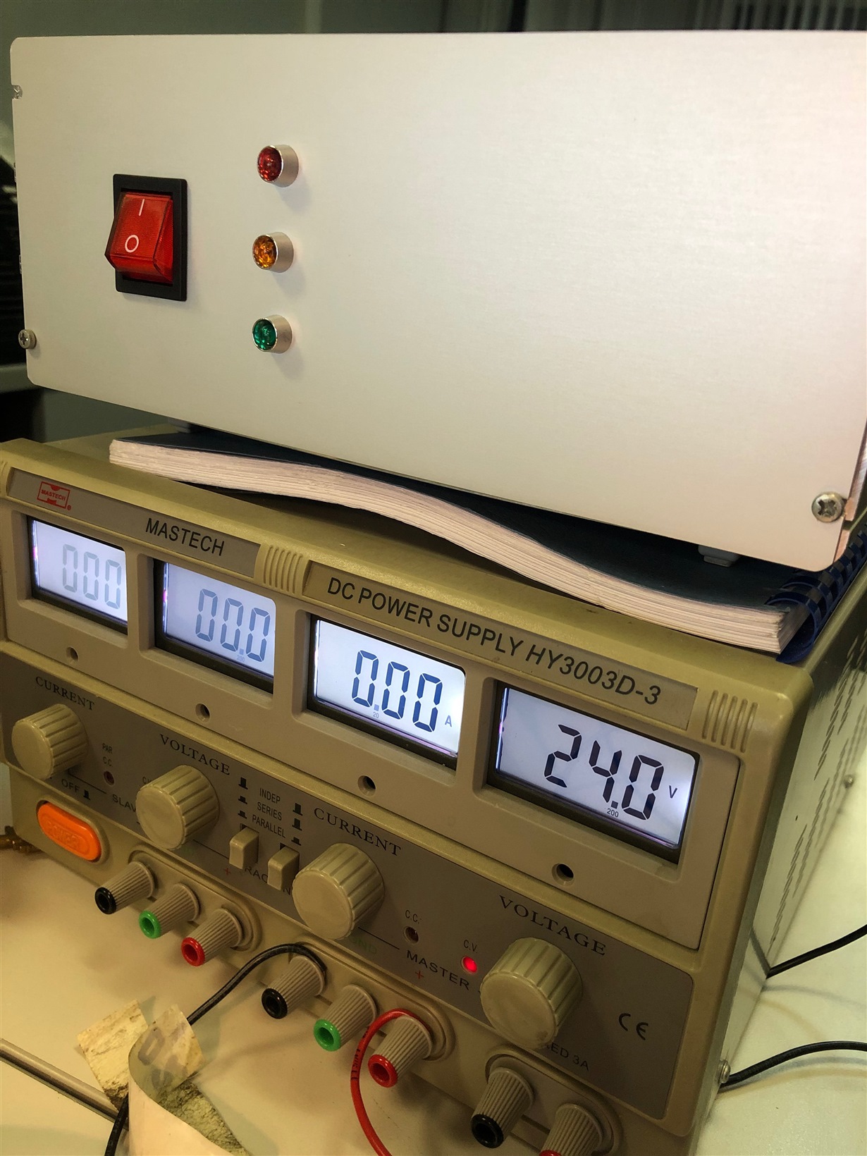

Hello.
I use BQ24650 to charge a 12V sealed lead-acid battery (I used the instructions www.ti.com/.../slva437a.pdf). The battery is shut off using a mechanical switch. The input voltage is 24V from the power source. The voltage from the battery is increased to 24V using TPS43061. An operational amplifier is used to protect the battery from full discharge. It switch off the ground when the voltage drops to a certain level.
The charger behaves strangely. If I first switch on 24V power to the input, and then connect the batteries, then charging does not start. Also, when the target voltage is reached, the current drops to almost 0, but the charging end LED does not light up. When the batteries are turning off, the charging indicator flashes several times.
Could you help to solve these problems?

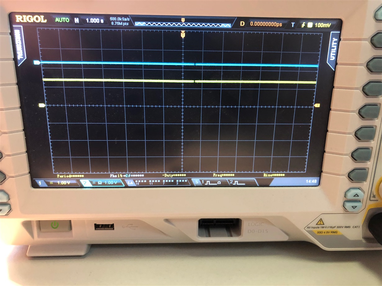

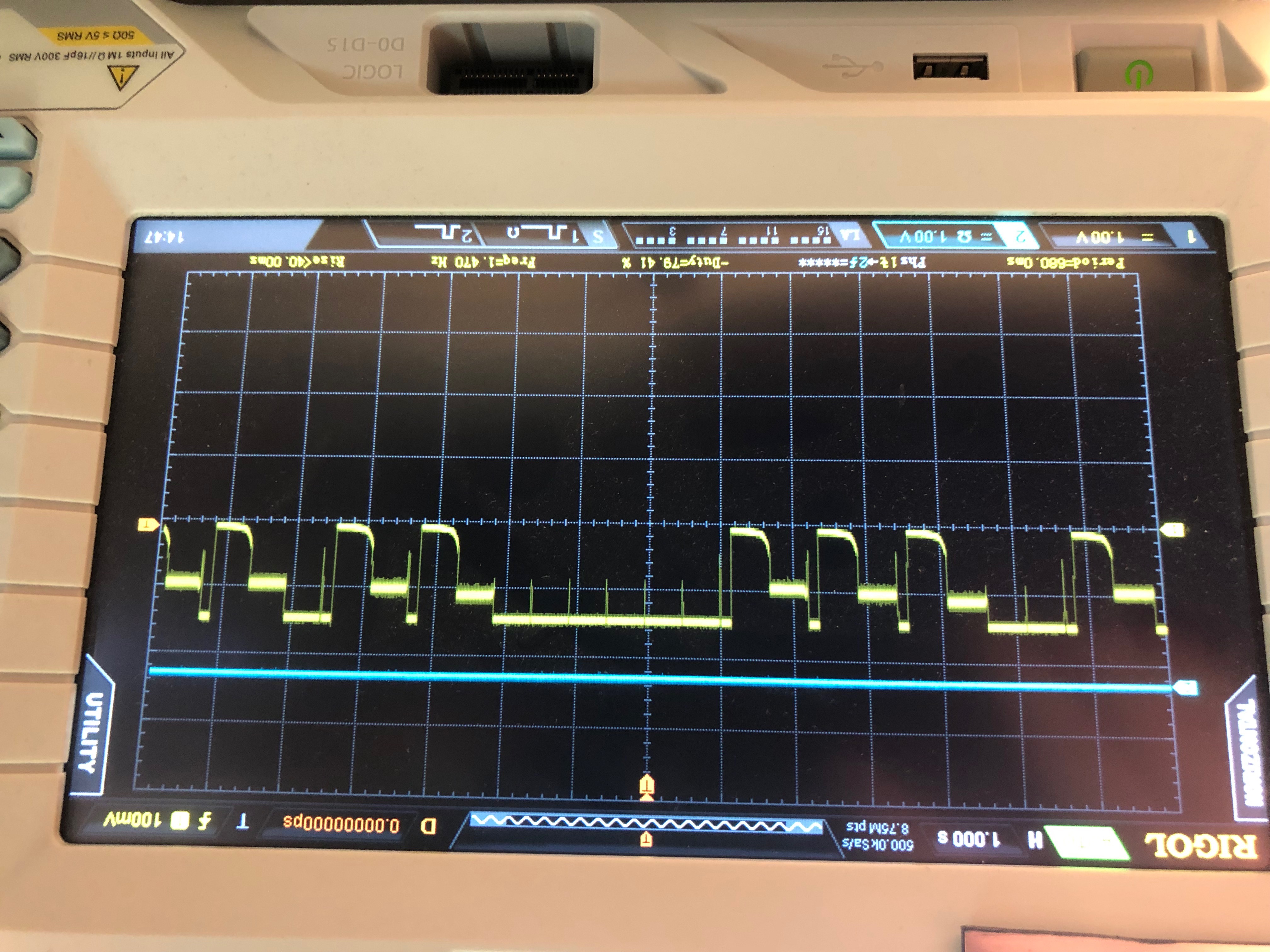

  • The scope capture close to C22, C23 then the battery off (yellow line) At this moment STAT1 LED is blinking:

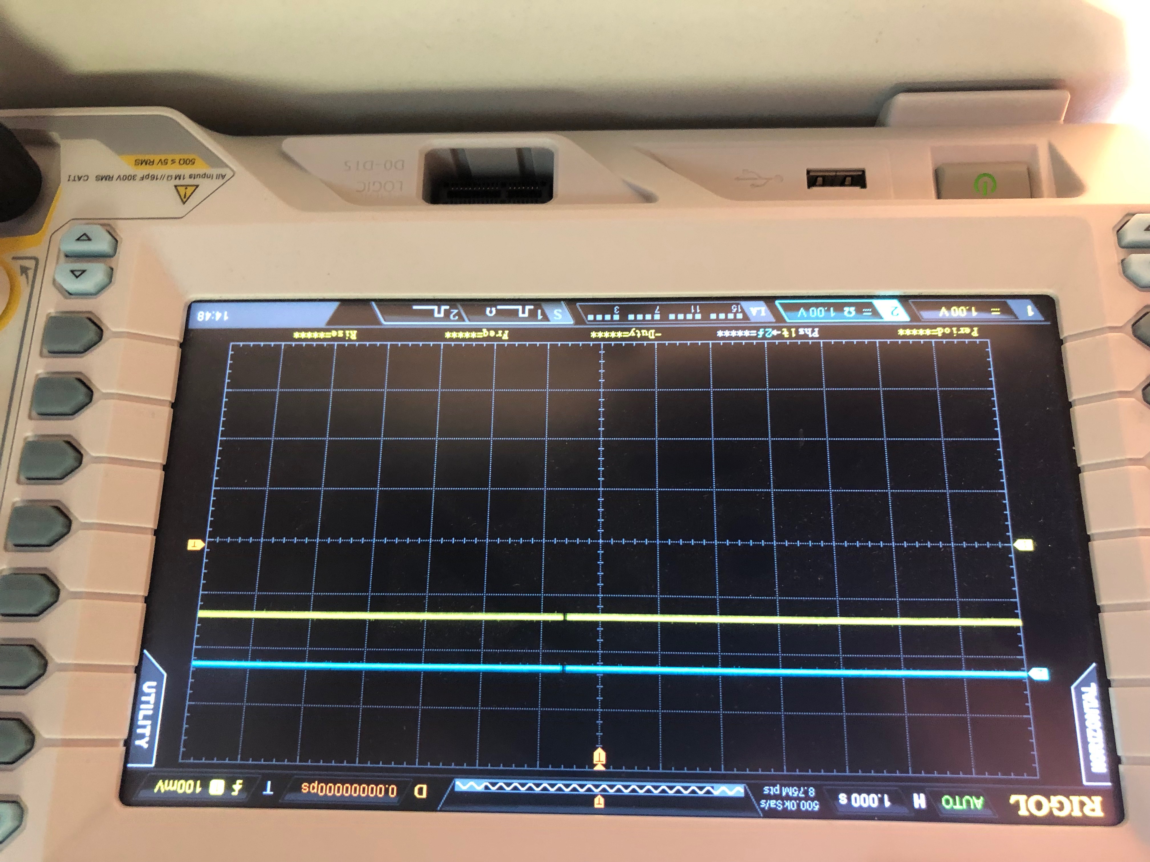

    The scope capture close to C22, C23 then the battery on (yellow line):

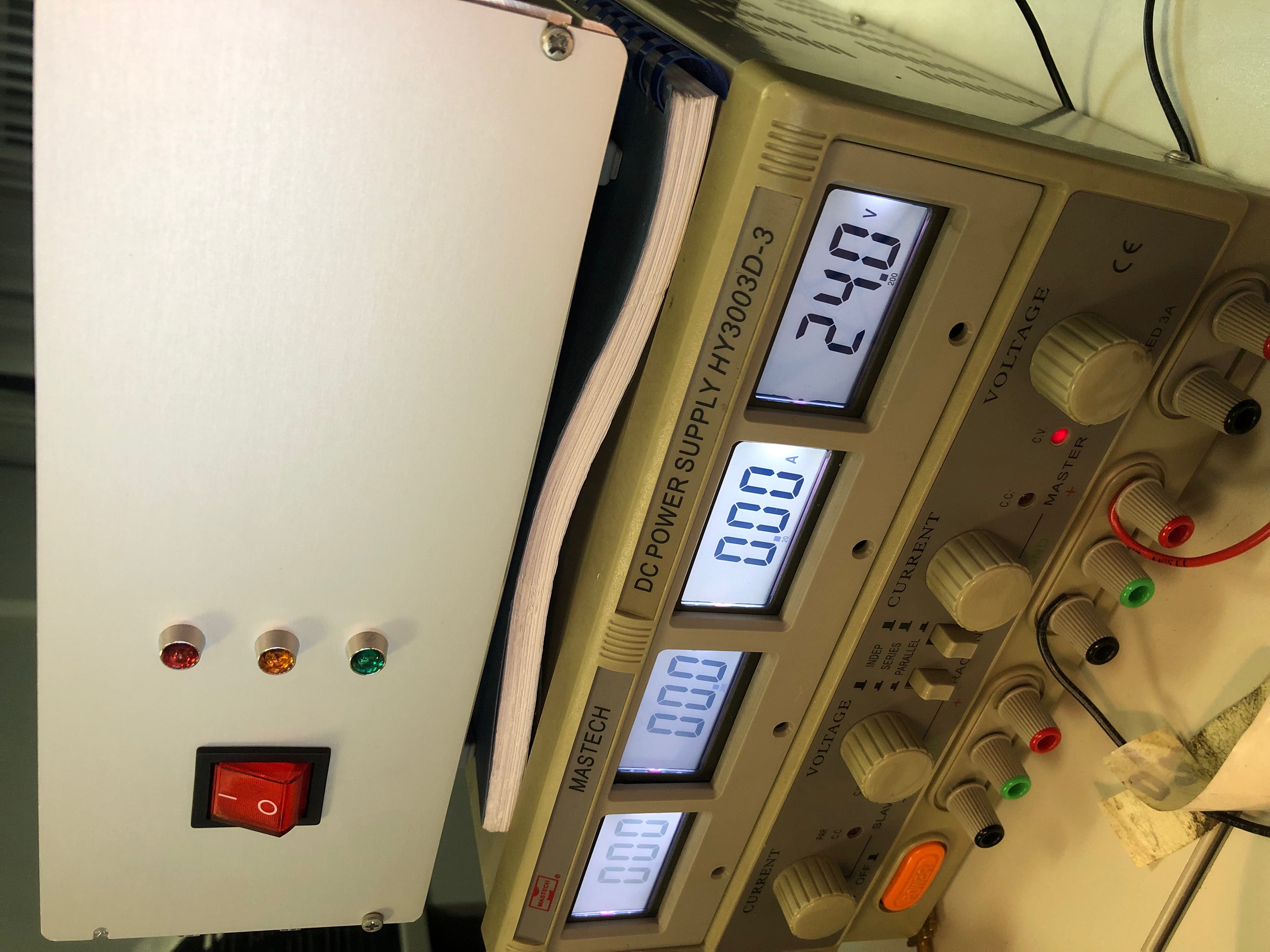

    I connect the labor power source to VCC and It show the current. On the second picture the current is about 0 A. At this moment STAT1 LED is swith off.
    LEDs connected to P1 Header 3x2 in schematic.
  • Hi Vladimir,
       From your scope capture, your CH1 has a scale of 1V, and you are only seeing about 1V to 2V on SRN?
