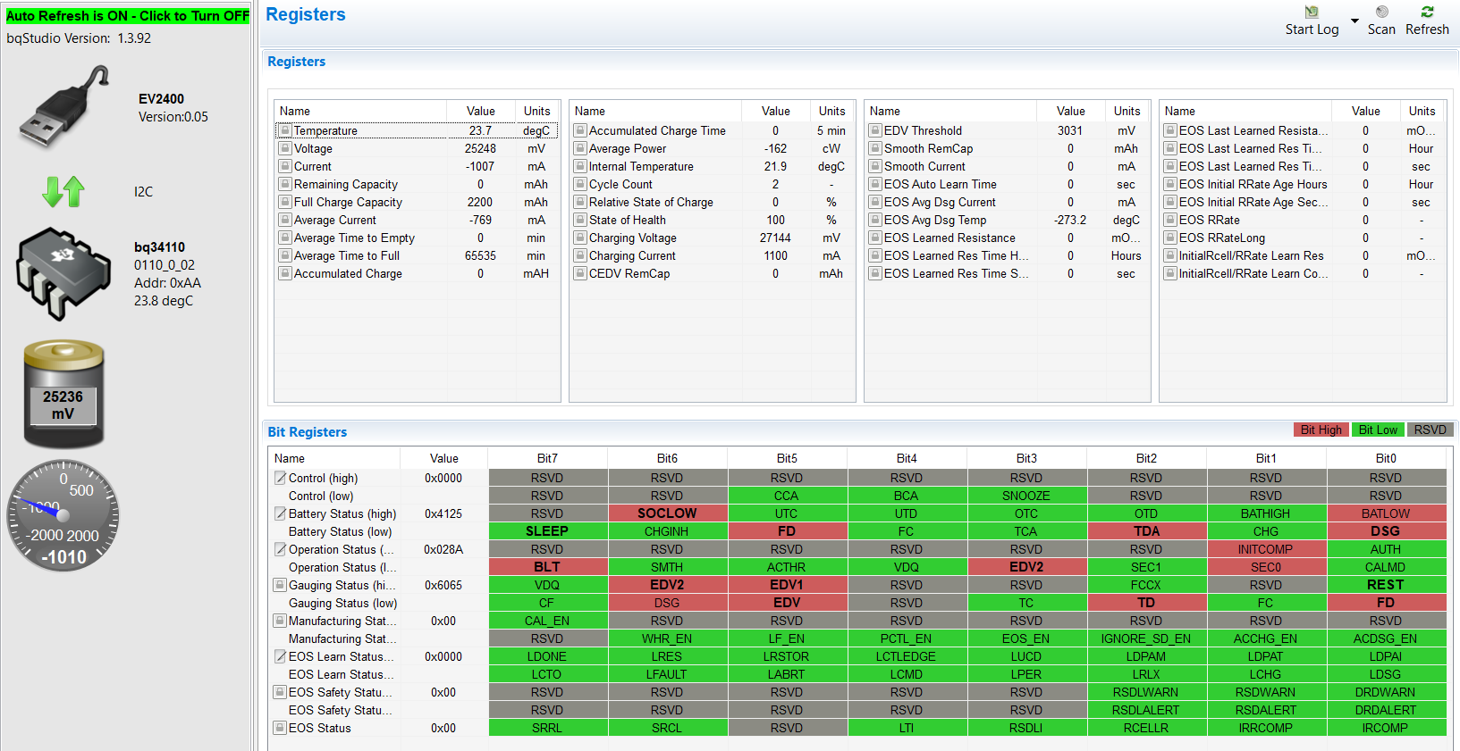

I am using the BQ34110EVM with a 12V 7.6 AH Lead Acid battery. I have completed the 6 discharges and the CEDV calculator tool and transferred values over to BQS. When i begin a discharge however the Time to Empty remains the default value of 65535. What parameters am I missing from Data Memory?BQStudio.gg.csv
