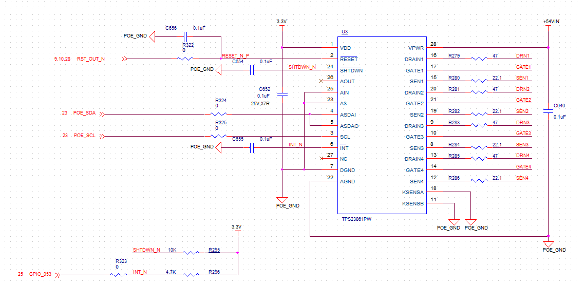

Here's one problem:

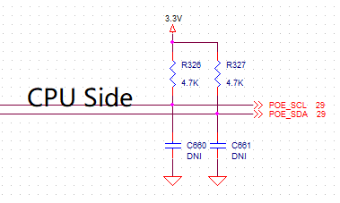

Only supply 3.3V currently for test, the Signal Level of SDA(TPS23861) is always low, therefore, we cannot access it by i2c bus.
The reset and shutdown both are high level.
Could you give some ideas for this?
PS: Could you show me the correct waveforms of SDA/SCL for reference?
Thanks.

    Did you supply power to Vpwr? TPS23861 need both Vpwr and VDD to be full functional. And You will need also to follow power on sequence described in this app note. Thanks.

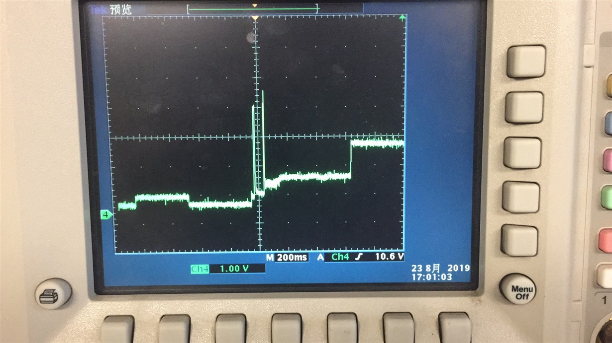

    Can you send me your settings of registers from 0x00 to 0x20? And it is good to have a waveform showing voltage between Vdrain and GND when you connect your PD. Thanks.

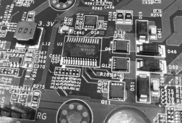

    IC mark:
    Waveform showing voltage between Vdrain and GND when you connect your PD --> Here's the waveform

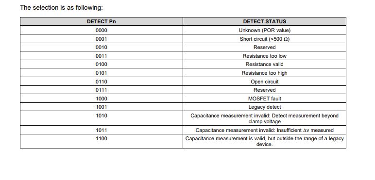

    Your status register 0x0C to 0x0F value(0x08) shows there are MOSFET fault happening on all ports. Please check the MOSFETs and replace the MOSFETs and try again. Thanks.
