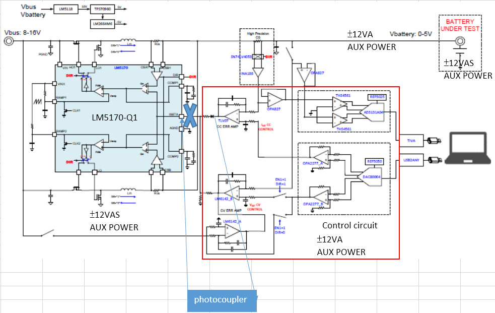

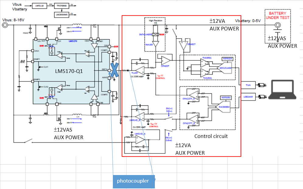

Hi TI Team
We have a project that will design in LM5170-Q1.
We have a problem we want a high precision/accurate outer current sensing.
We set the outer current sensing circuit at the voltage output positive port(as a ground of current sensing circuit).
And the ground of LM5170 is setting at the voltage output negative port.
So, two parts have different ground, how can I connect them?
If we use the optical coupler/photocoupler, the system bandwidth will be limited by it.
Could I have the other way to connect two circuits but different ground?
Or how could I solve the bandwidth of coupler/photocoupler?
By the way, the outer current is for the whole system and the signal will deliver to LM5170-Q1(inner current loop).
