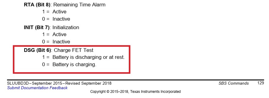

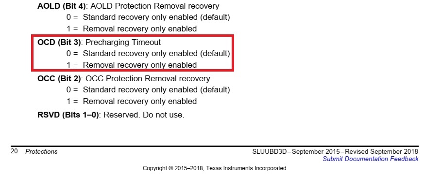

Hey. Studying the BQ78350-R1 Reference manual (SLUUBD3D), I found several controversial points. Please note, perhaps this is an error in the description?
1. Page 20, Bits description, OCD (Bit3) - Described as "Precharging Timeout" - I assume that there should be a parameter "Overcurrent DIscharge Removal Recovery"
2. Page 129, Bits Description, DSG (Bit 6) - Discribed as "Charge FET Test" - Perhaps there should be DSG transistors here? Or does it mean that this flag acts as an indicator (When it is cleaned) of the charge process?
