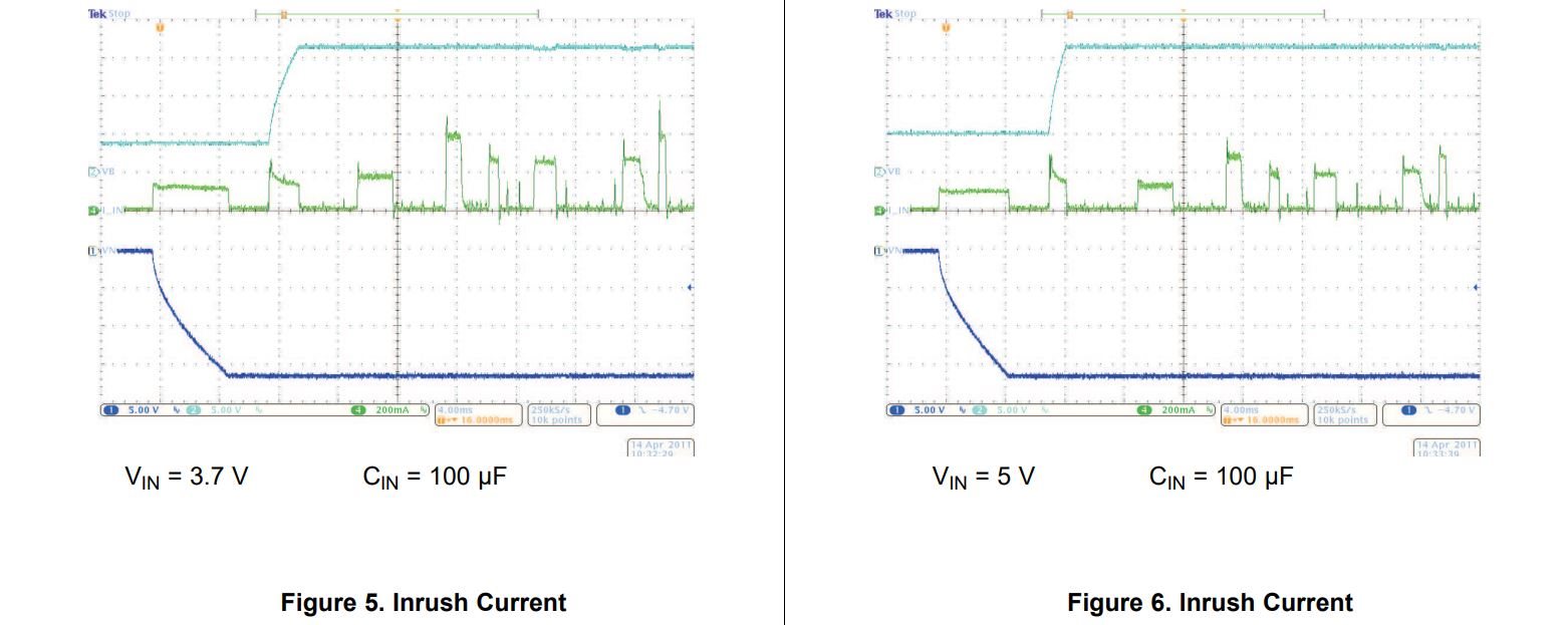

    Due to the internal soft start feature on each rail, the device must startup into a small load to ensure each output capacitor charges to the desired output voltage within the 50-ms time-out window. Once all rails are properly regulating, a larger load like the E ink display can be applied. Another point to keep in mind is that, for switching converters operating with a fixed output power, decreasing the input voltage results in a larger input current. This can be seen by the difference in inrush current in Figure 5 and Figure 6 of the datasheet:

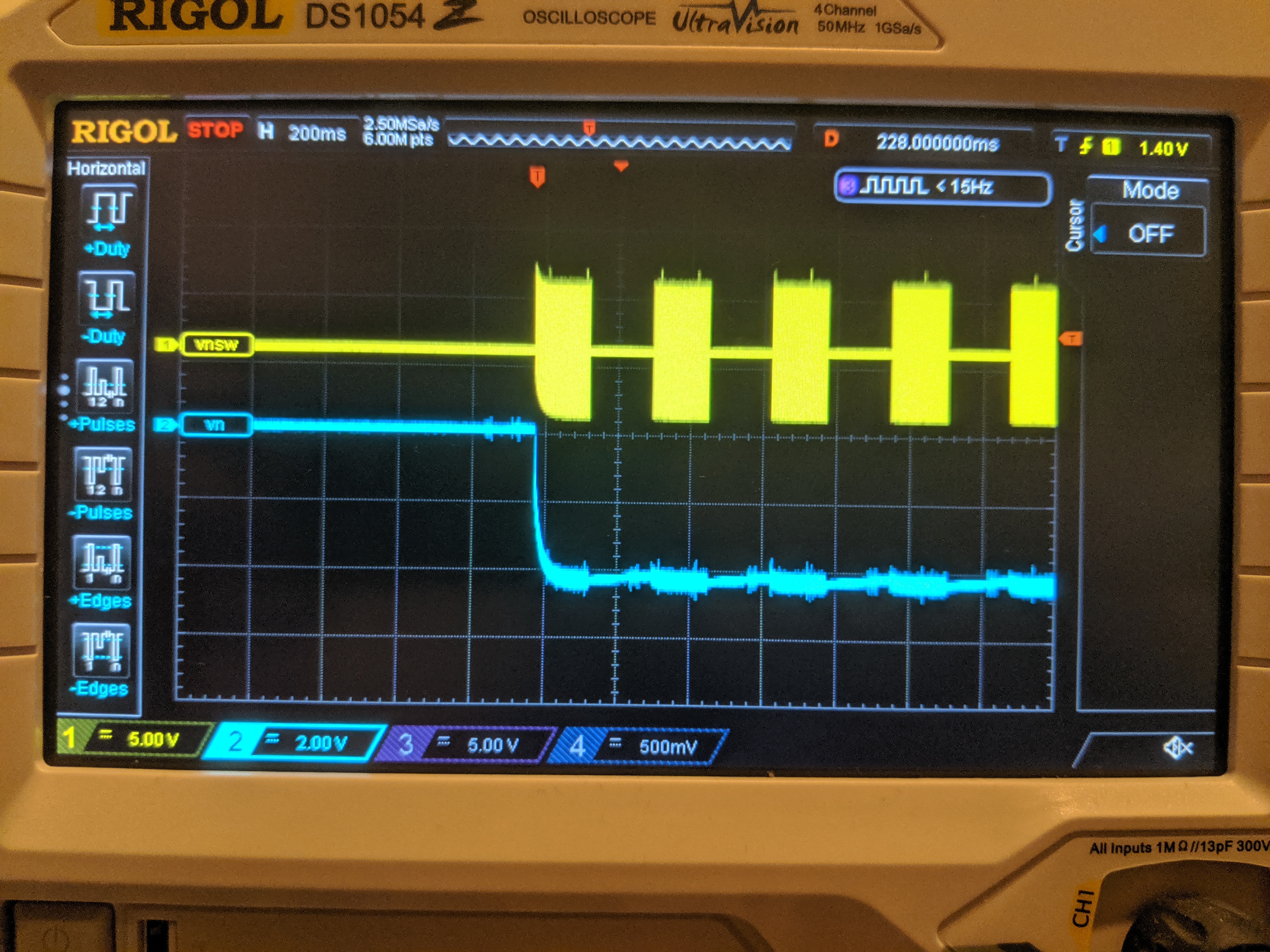

    Reg 1 alternates between 20 and A0 as the microcontroller repeatedly tries to re-enable the rails.The VN rail sits at some -4V, which clearly is what's triggering the undervolt flag. A scope shot of the output rails doesn't tell much as they're all stuck at zero, but here's VN and VN_SW at startup:
    VN_SW (yellow) tries to switch for about 150ms while VN (blue) converges on ~-4V. After 150ms, VN_SW gives up. Some 200ms later the microcontroller tries to start it back up again, but to no avail. It seems like almost a voltage reference problem, but the reference looks good.

    During the first period of switching cycles, the VN_SW node unexpectedly seems to clamp at -5 V after about 50 ms. The subsequent periods look almost symmetrical in that VNSW is always switching between +/- 5 V.

    Regarding VN_SW clamping at -5V, that was actually with a 3.7V supply. It's also not a "hard clamp", it floats around by a few hundred mV. A second unit shows identical behavior but at ~-7V.
    Looking at a zoomed in capture of VN_SW at startup, I think I may have found the issue. It seems to oscillate at around 5MHz:

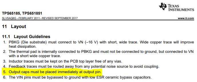

    This is reproducible between units, with a slightly varying frequency. The signs all seem to point to feedback stability issues. How embarrassing if true. Changing the input voltage would change loop dynamics, which could throw it in or out of stability. Same with a varying load. Looking at my layout, I perhaps could have been a bit tidier with the VN_SW node:
    not only is there a fair amount of inductance in the loop, but I also chose to decouple the feedback node (pin 26) through a via. Now onto validating that this is the case, which I haven't come up with a way to do so yet. And attempting to resolve it without respinning the board. Perhaps a feed forward capacitor between pin 24 and 26? What do you think?
    I agree, consistent, reproducible oscillation on the switch node does point to a stability issue due to PCB parasitics. The main cause for concern based on the layout snippet above is placing the device and output capacitor(s) on opposite sides of the board - the Layout Guidelines in the datasheet state that they must be placed at pin:
    A capacitor across the power FET or rectifier diode is an option to avoid redoing the layout. A series resistor could also be added to further improve stability at the expense of additional power dissipation. John Betten has an article on EE Times describing how to calculate these snubber components here:
