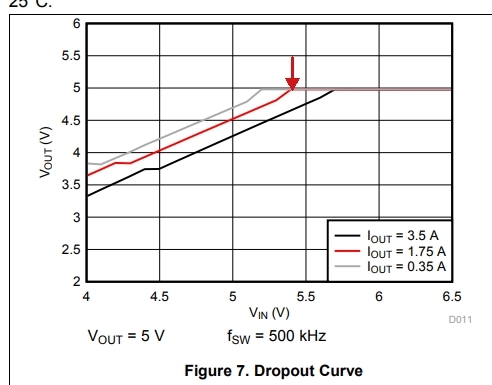

Dear team,
Could you please help answer below questions?
1. What is the input voltage at the red arrow in the figure below? 5.4V?
2. If the output voltage is 5V, the output current is 1A, the switching frequency is 500K, and what is the maximum Dropout voltage at –40°C to 85°C?
