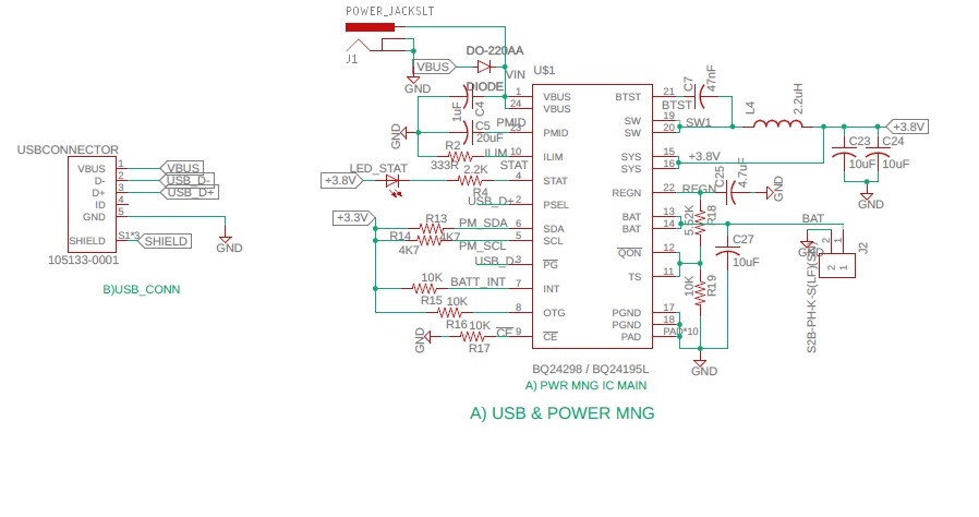

  • This is the schematic what i have used
  • Hello Ricardo,
    Wire.beginTransmission(BQ24195L_Slave_Address);
    Wire.write(BQ_REG[4]);
    Wire.write(0x59);
    Wire.endTransmission();
    Wire.requestFrom(BQ24195L_Slave_Address, 100);
    this solves my issue i get required voltage at STAT i.e 3.8v
    using this value Wire.write(0x59)
    Thank you,
    Nishikant
