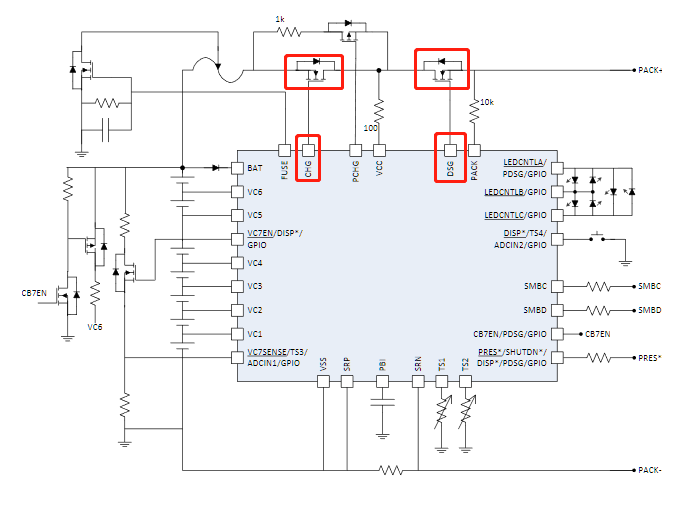

Dear TI Experts,
For BQ40Z80,if the DSG & CHG could be divided? that we can CHG & DSG independently。
Do you have any suggestion?or can provide some reference design

Hi Kane,
If you mean using parallel paths for chg and dsg, yes, you can do that. However, if you do that given that you will have to connect dsg FET drain across source of chg FET, you will lose reverse polarity protection. You can do it. We do not recommend it. We also don't have a design.
