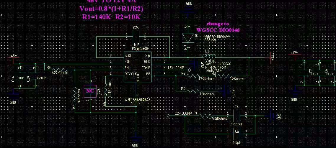

   I use TI TPS54560B. It can be seen from the product description that Vin(Max):60V,Vout (Max): 58.8v and Iout (Max): 5A,I do the actual test, the questions are as follows, please answer:
1.I use input 53V and output 12V. When the current reaches 2.5A, the output voltage jumps. Why?
2.Output 12V/3A, is that possible?
Schematic diagram is as follows:
