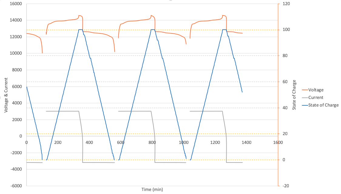

A system based on BQ34Z100-G1 and a 12V LifePo battery (10000mAh) get 100% in SOC during charge at the beginning of the constant voltage stage. Below a graph showing the charge stage.
The BQ34Z100-G1 can be set in order to hit 100% SOC on charge termination?
The FC Set% is equal to -1 and the device pass the learning process.
Thanks for any suggestion,

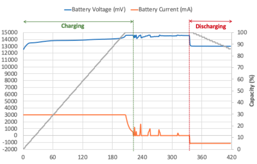

  • Hi Batt,
    Thanks for explain further details about RSOC_HOLD and the relation with this situation. Please, may you suggest a similar device with most recent firmware?
    I performed various cycles and get similar results with RSOC_HOLD active, as show the graph below.
    I will reduce the taper voltage as suggested and test again. I will change from 100mV to 50mV. If you consider a different value, please, let me know.

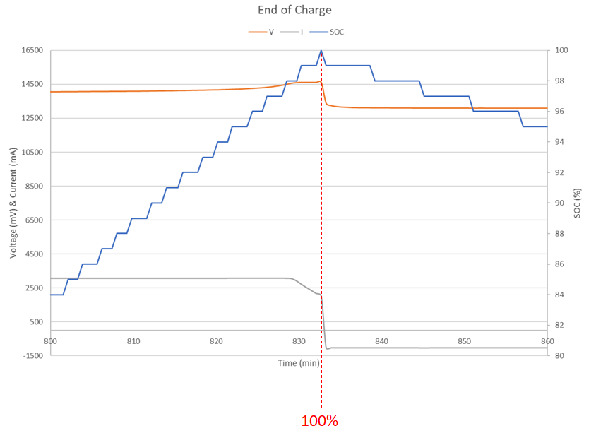

  • Hi Batt,
    The RSOC_HOLD was disabled and new test was performed. The results look much better. The SOC hit 100% with lower charging current than before, which is good for this application, where the charger must be disable at 100% SOC.
    In the first post, you mention "reduce your taper voltage with RSOC_HOLD to see if that holds off RSOC at 99% until you reach taper. But do not use that if you use SMOOTH in pack configuration" and I'm still a little confuse, because in one hand you mentioned enable "with RSOC_HOLD" and in other, to disable.
    Just to be sure, there is not misinterpretation from my end, please, may you confirm the variables used during the latest test match with your suggestion in order to hit 100% SOC in taper current:
    • Disable RSOC_HOLD
    • Taper voltage: 50mV
    • SMOOTH: enable (I don't have facts on this, but I could prefer to keep the SOC value smooth for the user, as suggested on the TRM)
  • Hi Lao,
    I'm happy this solution worked for you. You can stop chg after 30 seconds once capacity hits 100%. Yes, your settings to hit 100% at taper are correct. If you are using SMOOTH, do not use RSOC_HOLD. Otherwise it may affect gauge performance.
