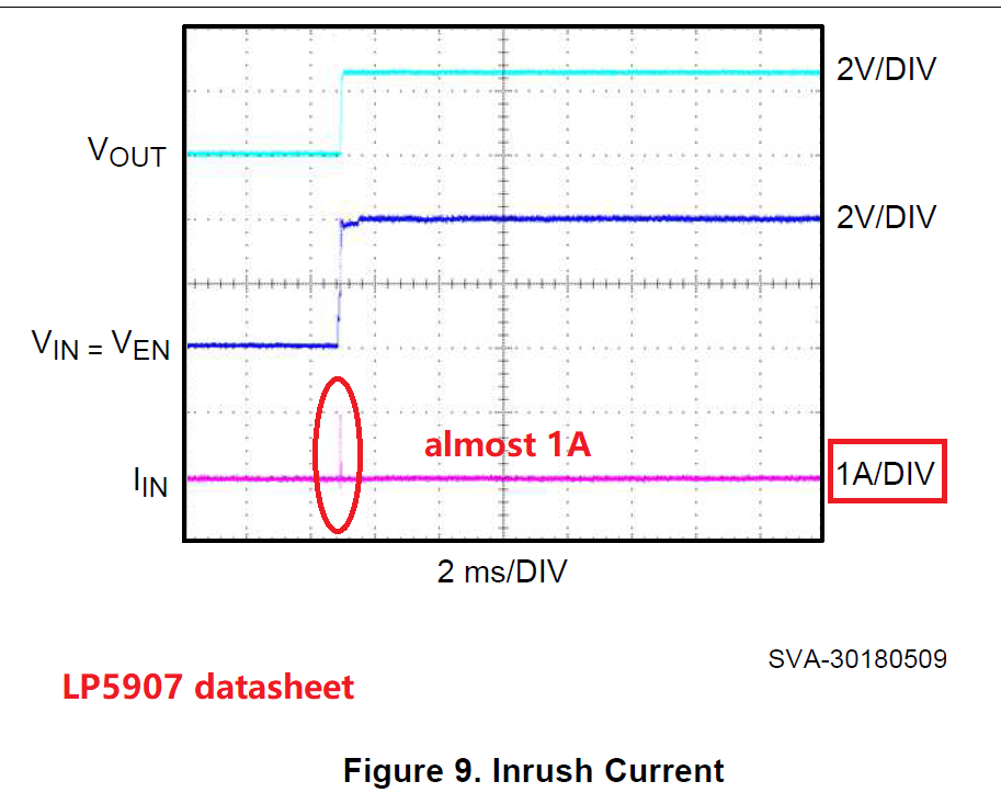

I find that the LP5907's inrush current is relatively high.
Is there a P2P-replace LDO with a low inrush current and same price?
The lower inrush current, the better.
Hi Tammy,
Today we do not have have a P2P on this YKE package for the LP5907. We have other LDOs with improved inrush performance but not in this package.
